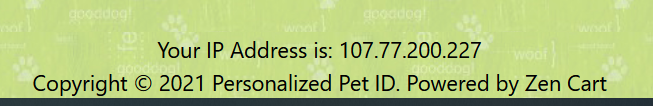

The Zen Cart Documentation says to change the powered by zen cart information in the stylesheet. This template has numerous stylesheets and I cannot find this in ANY of them. I was able to add my website name somewhere along the way, but I can't locate the file again. I also want to remove the 'your IP address". I also don't find anything for that in the stylesheets. Where can I chance these two things?
Attachment 19538
Yep, the reference in the docs suggests leaving the Powered By in the footer and I agree. https://docs.zen-cart.com/user/templ...ter-of-my-cart

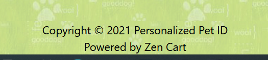

Thanks, y'all! This looks MUCH better!
