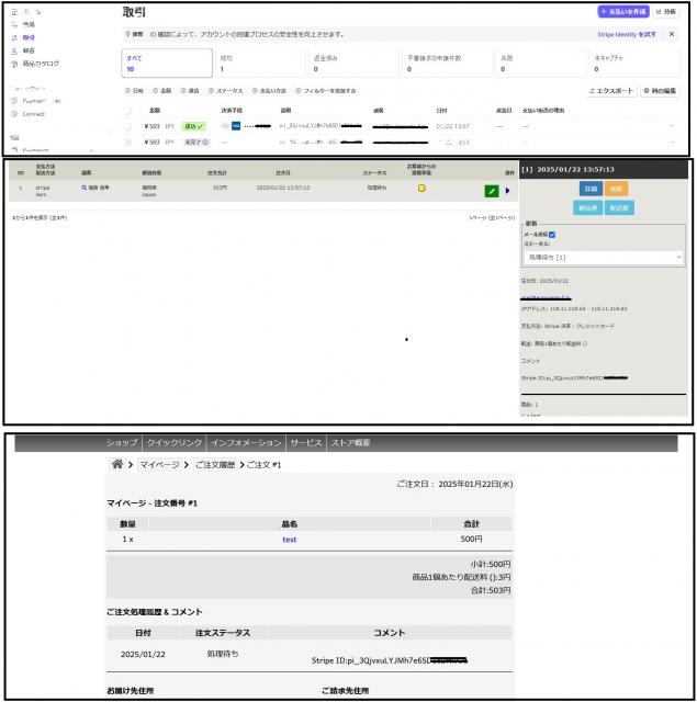

I've checked live site using Googlepay.
Payment was made twice, 1st payment is failed and 2nd is succeeded.
And zen cart was also succeeded.
It works everything.
