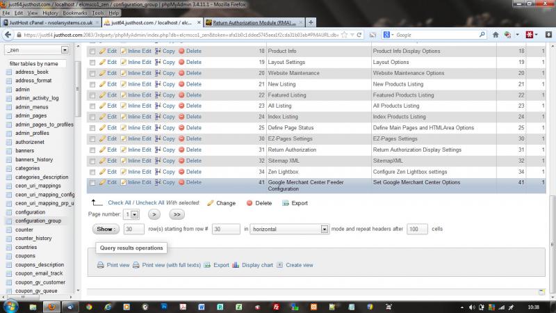

Hi Diva was not sure if I could as it could be a back door to you admin and could affect your pci compliance.
first off this is a dirty work round till someone with more brains than me kindly upgrades this mod :hug: also make sure you have a really strong password to your admin ( I use lastpass as it generates a password for you and is a free os application ) my host uses C Panel and this is based on that control panels layout
1 login to you hosting account and find the link to php MyAdmin and click on it
2 then find your data base name and click on that
3 You should then see a list on the left of all the tables in you database
4 find configuration_group and click on that
5 scroll down the list of tables till you find Return Authorization Return Authorization Display Settings see image and make a note of the number in the configuration_group_id column and keep it should you need it again
Attachment 11792
6 type the following in your address bar http://
www.your domain/
your admin name/configuration.php?gID=
the ID No You noted in step 5 this will take you to the settings screen for Return Authorization and change the settings to you requirements
done
