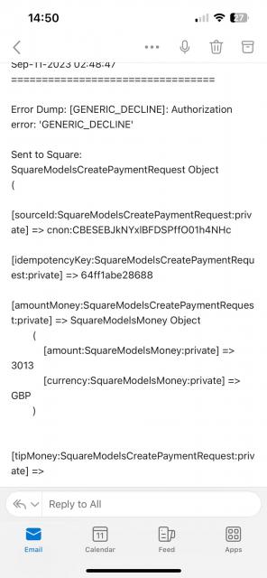

I'm now getting these errors as well.
Since you did not answer any of the posting tips, this is possibly more informational than helpful.:( I have no idea if you are using OPC, a template that might be a problem, or some other situation.
A generic decline means that some information was not entered or entered incorrectly. Since the billing address/zip is an important part of the transaction verificaton, payment gateways will never specify to the customer what was "generically" incorrect. It gives information that bad guys can use to get information not found on hte card. Since the newest WebPay is set to not allow checking out without filling the form with all the info, my money's on the information being incorrect.
One problem that comes up in Chrome and other browsers is that it may be set to automatically fill in the shipping/billing and has a tendency to add the city into the Address 2 block. That will cause a generic decline. Another instance is a user with a corporate CC using their home zip instead of that for the card's billing address. Both situations result in a generic decline.
Review every entry on the checkout page

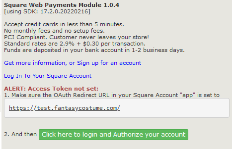

I ran the test.php and the array is coming up empty. I also compared a fresh download of 1.5.7b to my files. There are no differences in the core files.
The OAuth Redirect URL in the module appears to be wrong. It does not include "squareWebPay_handler.php".
Attachment 20388
If I have squareWebPay_handler.php in my OAuth Redirect URL in developer.squareup.com, I get a blank white page when clicking ""Click Here to Log in and Authorize Your Account". But if I leave squareWebPay_handler.php out in my OAuth Redirect URL in developer.squareup.com, it redirects to the website main page, but the token does not update in the payment module.
Do you know why the requested OAuth Redirect URL in the Square Web Payments Module is not requesting squareWebPay_handler.php?
test.fantasycostume.com
zen 1.7.5d
Php 7.4
LOL..type on ver...1.5.7d
xxxxxxx

We are now receiving emails stating:
Code:Jan-18-2024 11:01:54
Error Dump: [UNAUTHORIZED]: This request could not be authorized.
Sent to Square: SquareModelsBatchRetrieveOrdersRequest Object
[locationId:SquareModelsBatchRetrieveOrdersRequest:private] =>
[orderIds:SquareModelsBatchRetrieveOrdersRequest:private] => Array
[0] => nwMNvXeqAS9HsQJmL72KKDSDZtOZY
I never suggested there was an issue with the code - I am convinced its an environment issue - I'd just like to have a solution to give my clients.

Hello, does someone have a recipe to configure Square webpay using Square SANDBOX. I'm not sure I understand what to do with the extra questions when you select SANDBOX application ID & token.
Hi Carl,
I try to configured my DEV website connect to my SQUARE SANDBOX. But I can't make it works, the bullet always stay "Yellow".
what I did:
1) I define in the Square developer Sandbox the URL of my DEV website: https://www.pechesudv155.owally.com/...ay_handler.php
2) I define the Application ID and Application Secret (OAuth) with my Square Sandbox key, enable Enable Square Module (True)
3) I see the URL https://www.pechesudv155.owally.com/...ay_handler.php and try to click on the green message "Click here to login and authorize your account"
4) but I receive a message from Square, telling to me : To start the OAuth flow for a sandbox account, first launch the seller test account from the Developer Dashboard.
5) So on Square panel, I click on "Authorize an account" and "Default test account", with the "default test account" I got a window with the Access token inside.
6) So i go back Square Web Payments Module and input the "access token" to the field "Sandbox Merchant Token"
But the bullet still stay yellow.
Could tell to me what I do wrong ?

peter,
unfortunately, i can not provide any additional support for the sandbox set up. it is there for developers to work with.
it seems that you had square working and that your problem was with super orders. so now you want to move on to enabling a sandbox account on your live site so that you can get it working with super orders? noting that super orders is a product that has not been updated for quite some time.
there is a lot going on; and unfortunately i do not have the time to resolve your sandbox set up.
maybe someone else can help you out; but it goes beyond what i am able to provide in this free forum.
best.
As a suggestion, rather than trying to create a sanbox setup, just create a second production App for your test environment (give it a meaningful name like "testWebPay") and run $1 transactions against it.
