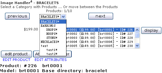

Only the category "bracelets" can be choosed, the others are invalid. As what you can see on my store, all of the products of every category can show very well. The link:www.moimoii.com

Great.. now can you save me the trouble of rooting around your store and randomly clicking on links looking for stuff please??:lookaroun Please provide what I asked for before and post links to SPECIFIC PRODUCTS IN YOUR STORE where you see the issue and then post links to SPECIFIC PRODUCTS IN YOUR STORE where you don't have the issue.. Screen prints of your admin are not very helpful...A
lso you can only CHOOSE categories with an asterisk next to them.. So you can CHOOSE "Drops", but not "Earrings"

I mean I can't see anything wrong with online catalog (www.moimoii.com), at least not show on the website. Every product has small, med and large pictures which are showed very well by zen-lightbox , so there is no SPECIFIC PRODUCT which have issue on my website. The point is some of the categories can't be chosen and product-edited in admin/tools/IH/image manager, for example I can't add an additional image for product. Once I choose those categories, it will jump to the interface of admin/tools/IH/admin tools. (By the way, I only choose categories with an asterisk next to them). And I tried to use IH through clicking on the small IH icon of categories/products/one product, it also jump to the interface of admin/tools/IH/admin tools.
