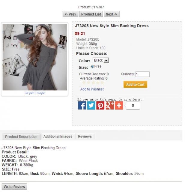

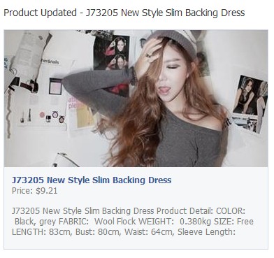

I need help.
I have used autofacebook plug-in to upload the products information to facebook, but the pictures on facebook are completely inconformity from the website. The facebook has resized the pictures a lot and the pictures looks very twisted.
facebook info:
Attachment 13350
Product info:
Attachment 13351
how to fix?

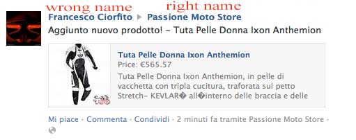

Hello guys, I have a small problem with the plugin.
I'm on zencart 1.3.9h and I installed the plugin using the video tutorial, but I have a problem with the automatic posting on my facebook page.
The posting doesn't come with my facebook page name but with my real name!
This is an example:
Attachment 13732
How can I fix it? Thanks!

zch0071
I need help.
facebook info:
Attachment 13350
Product info:
Attachment 13351
how to fix?

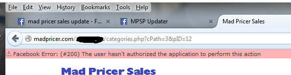

Having same problem getting blank page and same errors as everybody else.
Whenever I add a new Product or Update a product it takes me to BLANK PAGE.
[01-Mar-2014 01:43:38] PHP Warning: Cannot modify header information - headers already sent by (output started at /home/content/54/6674154/html/crochets/adminurrhtcqq/includes/modules/update_product.php:1) in /home/content/54/6674154/html/crochets/adminurrhtcqq/includes/functions/general.php on line 21

Basically, the product image is too large on my facebook page. Any fix?
Re: AutoFacebook [Support]
Rizla
I know there is no support for this mod but I'm hoping someone can point me in the right direction:
I use the module and there was no major changes in fb. If you follow the readme instructions it will lead you to success.
I' ll try to prepare some screenshots of my online autofacebook module to help as much as possible.
These are two screen shots of the before and now... AFAIK I have not change anything, but ya never know ;)
Can clearly see the software is only showing the middle part of the image (enlarged)
My mistake. I didn't notice that the Rizla was complaining about the fb posts. Yes that is a facebook change and does not has anything to do with this great module. So nothing to be fixed here :)
The way my autofacebook posts look like are as shown on the photo. Some pictures fit and some don't so i guess that has to do with the resolution of the product picture. Attachment 14256
Figured this out. I have added information to update_product.php and then created a test product. Upon completion it shows
Facebook Error: (#200) The user hasn't authorized the application to perform this action
My app is public. Any idea why I am getting this error?

Resolved but now when I create product it shows message "Facebook Error: (#200) The user hasn't authorized the application to perform this action"
I see in video when app is created, no category is selected but now it is required and for some we have to submit for approval.
Any idea how to get rid of this error message?

I guess you just need to reset the token to your page to make it work again. As menstioned on the well prepared readme file of the application by Jamie Taylor follow this steps to get a new token.
1. Open up the included facebook_authorization.php file and edit lines 4 and 5 with your App information.
Note: facebook_authorization.php is a simple file that we're going to upload to our server and run from our browser to authorize our application to do things for us like post to our page's wall. After if gives us certain information it is no longer needed and should be deleted.
So on line 6 where you see: $app_location = "http://yoursite/facebook/facebook_authorization.php"; This is simply the URL to where you plan to upload facebook_authorization.php. I suggest making a temporary folder on your folder called "facebook". However, where ever you plan to upload it, it must be on the same server you specified in Step 1 and make sure you reflect it's location on line 6. Once you're done editing lines 4-6 save and upload it to where ever you specified in your $app_location.
2. Once uploaded run the file in your browser and you will be taken to facebook's Permission Request prompt to authorize your app. Click "Allow."
3. You should now see a Success page with your page's ID and Page's Token. We need those for our next step.
Note: if you see a period (or any other punctuation) at the end of your page's Token consider it part of the token.
4. Open up the included update_product.php file in the admin/includes/modules folder and edit lines 90 through 97 with your Application Info and the Info given from the last step (Step 9). Note: $store_url needs to be the full url to your store without the trailing ('/'). So it should look like "http://www.mystore.com" or "http://www.mystore.com/store". Alos: lines 96 and 97 can be personallized or just left as they are.

Thank you for info but I have already done all this. I have removed app few times from profile and authorize it again and input new token in update_product file but it is not working. I was reading yesterday and it shows "manage_pages" require facebook approval now and have to submit app for approval. Is that sounds right?
Sorry to say but it is just a token problem. Try to verify the token you get for your page is right here cause it seems you are missing something on the procedure.
But the errors that you get means you don't provide a confirmed token to the application.
infogate
I tried and this page gave error: Failed to parse URL
I am copying token directly from page loads by domain.com/facebook_authorization.php
for example
[name] => xxxxxxxxxxxxx
[access_token] => xxxxxxxxxxxxxxxxxxxxxxxxxxxxxxxxxxxxxxxxxxxxxxxxxxxx
[perms] => Array
[0] => ADMINISTER
[1] => EDIT_PROFILE
[2] => CREATE_CONTENT
[3] => MODERATE_CONTENT
[4] => CREATE_ADS
[5] => BASIC_ADMIN
[id] => xxxxxxxxxxxxx
I have replaced actual values with xxxxxxxxxxxxx here.
I have also entered same token and id to update_product page with other information. Not sure what I am still missing which causing this error.
Suggested solutions
1. Double check that you provide the correct token to application
2. Double check the following information are corect before run the facebook_authorization.php
//edit with your info
$app_id = "xxxxxxxxxxxxx"; //given when you created app
$app_secret = "YYYYYYYYYYY"; //given when you created app
$site_url = "http://www.yourdomain.com/facebook_authorization.php"; //full path to location of this file.
3. Double check that you provide correct information to the update_product.php
//AutoFacebook
$app_id = "xxxxxxxxxxxx"; //given when you created app
$app_secret = "YYYYYYYYYYYY"; //given when you created app
$page_id = "KKKKKKKKKKKKK"; //obtained from running facebook_authorization.php from your browser
$page_token = "VERY LONG STRING YOU GET FROM facebook_authorization.php"; //long number obtained from facebook_authorization.php
4. Double check Application ---> Settings ---> Migrations ---> ON
If you follow all the above and try not to mix the information from page_id and page_token with other pages you might created in facebook everything will work perfect.

help please, i am a newbie
i cant get autofacebook to work ihave check and double checked ids and token access codes
i keep getting this error
Error Facebook Error: (#200) The user hasn't authorized the application to perform this action
can some one tell me what i am doing wrong, facebook setup is so confusing
The reason is that publish_stream is now deprecated; use publish_actions instead.
943: $perms = "publish_actions,manage_pages,offline_access";
