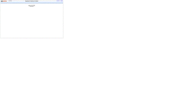

Here is a screen shot of the import page and the error I keep getting. As you can see, the import stops at 900, and then the error pops up. Every single time.
Attachment 14680
Re: update of apsona_functions.php to use mysqli
There is at least one post in this thread about this and I believe he solved it by moving to a new host.

After these most recent posts to this thread, I have been checking to see if my ShopAdmin is still working. Well, it was - up until 3 days ago, when I moved to a different server. Although I have the same domain name, my url is now different (I am keeping the old url on the old server for 30 days "just in case"). Now, all I get is this:
Attachment 15102
Sorry about the little itty-bitty picture; I couldn't figure out how to make the picture fit the Forum's picture limits. What could be causing this partial loading of Apsona Shop-Admin? Do I need to change some config file that I don't know about? I tried logging in to the Apsona website to possibly change some portion of my account, but I don't seem to know how to do that either.
Is this even related to the server change, or is it something else?
Please advise.
Re: Apsona ShopAdmin - a free tool for import/mass update/reporting
It would have to be related to the server change unless you have also upgraded your zen cart or changed admin to secure. In any rate there's no way to tell without actually looking into it. If there absolutely no changes made whatsoever then perhaps your new hosting is the problem.

Is anybody having trouble with Apsona the last few days? I've been running it successfully on ZenCart 1.5.4 (I do have the patch installed) until yesterday. Now, for some reason, every time I try to mass delete products, or mass update records, I receive the message "The server is not responding." I can successfully export products but not delete or update. I can't even delete a product by selecting it individually. I have not changed anything locally and have tried it both on Firefox and Chrome.
Also, when I try to import records, the "manufacturer" field is not being recognized. It will not match the manufacturer in my .csv file to an existing manufacturer in the database.
Any insight any of you might have would be greatly appreciated.
