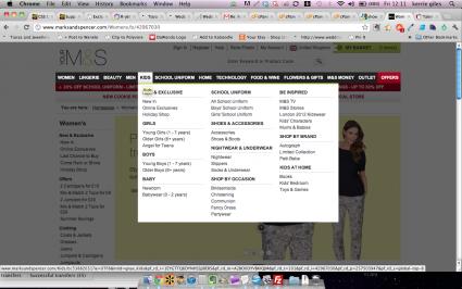

Love the mod, it goes a long way to doing what I'm trying to do. I'm trying to mimic the image with the main top categories showing along the bar and when someone hovers it show subcategories as individual headings with the next level of categories down showing directly under the heading.Attachment 10747
Any ideas?

kezan98
Attachment 10747
Any ideas?
Try this http://www.zen-cart.com/downloads.php?do=file&id=323 if you haven't already?

kezan98
Attachment 10747
Any ideas?
Looks like you're looking for a horizontal dropdown. This is a vertical flyout menu. Try THIS ONE (CSS Horizontal Dropdown Menu With jquery
). It should be a real good start for you.
Hope this helps.
