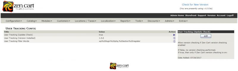

I've just installed 1.5.8 ( upgarded from 1.4.1 ) and it seems working.
The problem is log directory where I can see many errors as:
error:14090086:SSL routines:SSL3_GET_SERVER_CERTIFICATE:certificate verify failed,[errno] => 60))
#1 trigger_error(CURL error checking plugin versions: 60:SSL certificate problem, verify that the CA cert is OK. Details:
Do you know what problem is ?
PS. I don't use SSL , my ZC version is 1.5.5

I have disabled ( update check ) for from User Tracking Config , but still have the errors on log directory.
I believe the errors are reported only when I navigate in Admin pages.
Looks like the certificate associated with your server to be able to communicate with other servers has a problem. (this is different than the SSL certificate one would get to allow customers to connect via https:) yes it will be related to admin navigation as the version check software tends to only be built into admin related operations.
You could try to remove the admin/includes/auto_loaders/config.user_tracking_install.php file. This will prevent user tracking from checking for updates.
Thank you but I only have this file: config.user_tracking.php
deleting I have the same errors.

I think you looked in the wrong directory:
In a default install of this module, there would be two files beginning with config.user_tracking present.
Also, in the future, please use code tags when posting code. They are generated when clicking the # button in the message box toolbar.
Deletion of a file simply named config.user_tracking.php from either catalog or admin will prevent data collection of the module.
You're right. Thank you very much, problem solved.
Really appreciate you help.
good day.
Actually, not quite. The symptom of the problem has been solved, but the problem is still in a combination of your server's configuration and the plugin_support.php file.

I installed this mod on afresh installation of Zen Cart 1.5.5f, I added the lines of code for the admin and the storefront
<?php $zco_notifier->notify('NOTIFY_ADMIN_FOOTER_END'); ?>
and
<?php $zco_notifier->notify('NOTIFY_FOOTER_END'); ?>
respectively, but i am only tracking admin pages and no tracking of storefront pages.
Another problem i am getting not found when i click on"User Tracking Config",I searched the mod files but i could not find the file user_tracking_config.php, Where is it located?
In ZC 1.5.5, there is no additional action for the catalog side (ie. do not have to do anything to add $zco_notifier->notify('NOTIFY_FOOTER_END', $current_page_base); which is located in includes/templates/template_default/common/tpl_main_page.php and includes/templates/responsive_classic/common/tpl_main_page.php
As to User Tracking Config, that feature is added as part of the installation which generates configuration options to be selected from the configuration menu. As stated in a thread where installation appeared to occur continuously the install files need to be installed in their correct location (and also not in their incorrect location) to be able to perform the installation one time and one time only... Again, request to verify that the files located within the YOUR_ADMIN directory are not also duplicated to the catalog side.
