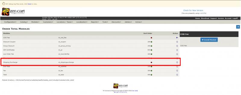

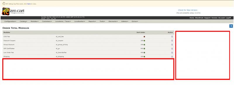

I've followed the instructions for unzipping and uploading the files for the shipping surcharge module and it shows up in the "Order Totals Modules" list.
Unfortunately when I click on it so the right hand side bar with the “Install” button should show up all I get is the partial list of the "Order Totals Modules" that shows above the shipping surcharge module. I see nothing of the list that should be below and no right hand side bar were the ”Install” button should be.
Image A
Attachment 19918
Image B
Attachment 19919
Image A
Attachment 19918
Image B
Attachment 19919
