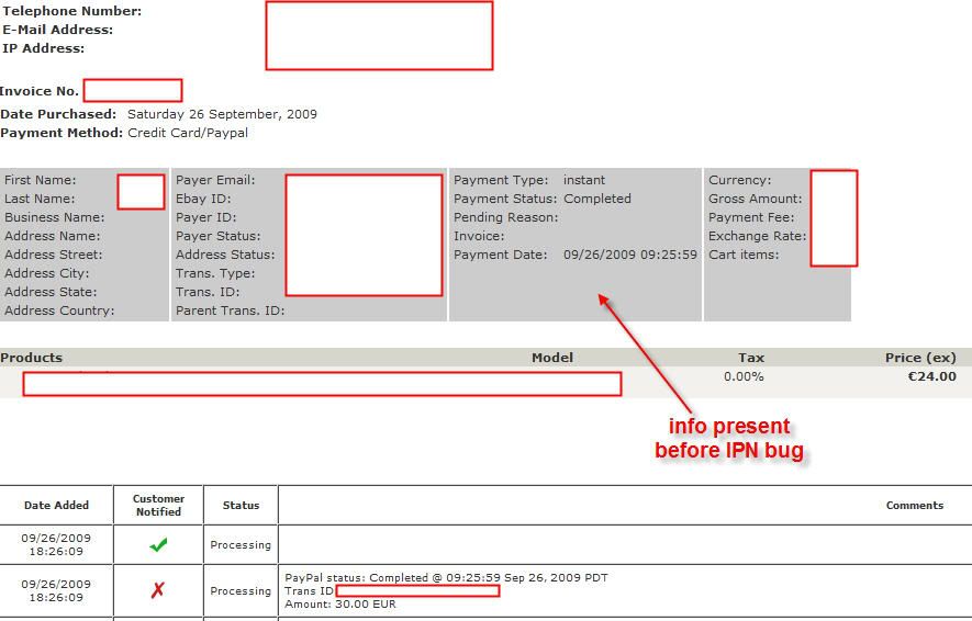

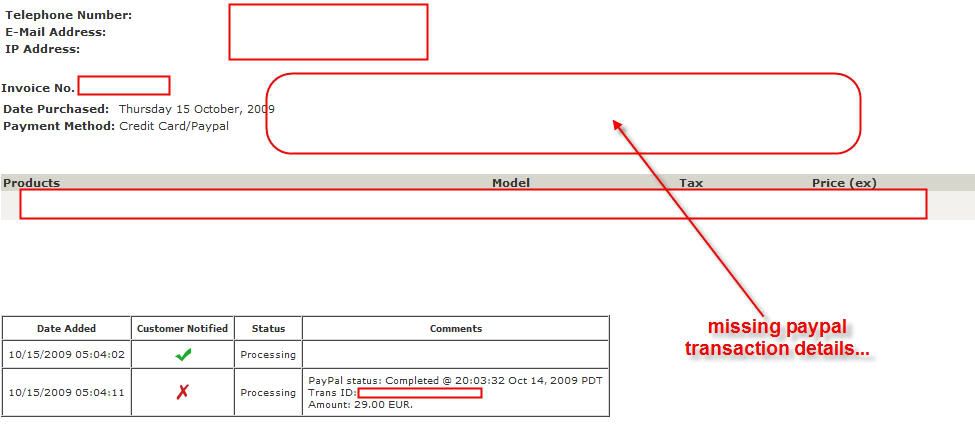

hello -- i am now getting positive orders however i am missing the paypal transaction details on the orders page. Please see images of before/after IPN bug.
Also, the redirect back to my shop is taking forever and is timing out ( a refresh gets me to the page after the time out)... how can i decrese the amount of time it takes to redirect... thanks
before IPN bug
http://i96.photobucket.com/albums/l1...art/before.jpg
after IPN bug fix
http://i96.photobucket.com/albums/l1...rt/missing.jpg
