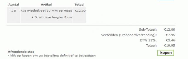

I was called by a customer yesterday, which i recently upgraded from Zen Cart 1.5.4 to Zen Cart 1.5.5a that in his shop the shipping tax is not calculated on the order confirmation page. The shipping module used, is the table module. In Zen Cart 1.5.4 this problem did not exist.
This is shown on the order_confirmation page

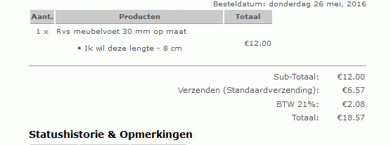

and this on the checkout_success
Attachment 16357
As you can see the shipping tax is missing.
The weird thing is when I use the zones module all goes well.
This is a store with almost no modifications, except for IH4, and mobizencart (mobile theme), but those have no effect on the check out process.

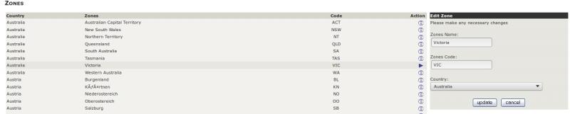

This is what I have:
Attachment 16359
And I have no zones for the Netherlands. Never had, because there is no need for. We do not use them for taxes or shipping.

In the Zone Details, if you Edit it what do you see:
Edit Sub Zone |
Please make any necessary changes |
Country: |
Zone: |
Re: Shipping tax not added in order confirmation - possible bug??
Ajeh
Does that help?
Attachment 16360
I would like you to go to Zone Definitions where the title on the page reads:
Zone Definitions - Taxes, Payment and Shipping
and click on DETAILS ... then click on it to see what is in the DETAILS of the Zone and edit that ...
Either it says Country Australia and the sub zone reads Please Select or you have each of the 8 sub zones in it ...

Okay, this I think is the issue ...
Where it says Please Select, do you see the 8 sub zones in the drop down?
If so, can you add each of the 8 sub zones?
Does it work?
Does it work?
Does it work?
Now added all 8 sub zones (previously the setting was 'All Zones' for Australia), did a test order and the shipping charge still shows without GST. Didn't think it would make any difference by adding all 8 sub zones as that is the same as have the setting 'All Zones'.

The interesting bit is that the shipping charge shows correctly (incl GST) during the entire checkout process (customer side) but is wrong in admin, order and invoice.

Now that triggered a light bulb: I did another test order using the new Responsive Classic template. And there it shows shipping with no tax included.
So the fault must be happening when confirming the order....

Hi all,
I can confirm the same issue happened to me upgrading from v1.5.1 to v1.5.5a. I thought I had corrupted something, but then found this post. I turned off the zone on the shipping module as suggested by Ajeh and it started to work as expected. So I've just implemented Dr Byte's suggested code change and all working again with a zone specified in the shipping module. I'll update you all if there are any logs or side effects appearing.

Hi all,
As an update to the fix DrByte mentioned. It works fine for my worldpay payment, however when a customer pays 'on account' using the invoice mod from the add ons the shipping is once again calculated without tax on the shipping. I can rectify the issue by removing the zone from the shipping module again.
