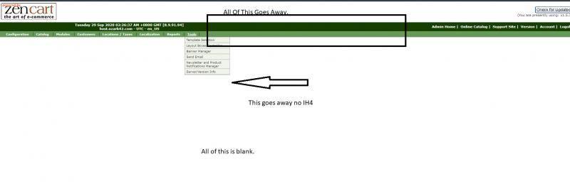

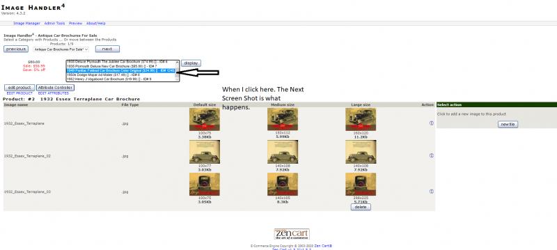

The first issue I have is: When I go to admin, click on tools and the Image Handler 4 tab everything comes up fine.
I added a category Antique Pontiac Car Brochures, as soon as I click on it, the whole pages under the tab bar disappears.
Here is a screen shot of before and then one of after.
Attachment 19221Attachment 19222
I'm not sure why it's doing that when I tried to do a postcard, it worked fine.
I originally added a new brochure to Antique Car Brochures which came up but as soon as I clicked on the Pontiac Car Brochure the same thing happened.
So I tried a new category and added the brochure there instead but same problem.

You may have accidentally removed or added a character that is causing the problem.
Following the docs at https://docs.zen-cart.com/user/troub...ng/blank_page/ may help.

The "blank part of the page" is indicative of a PHP fatal error that halted execution and therefore halted generating the rest of the page.
Follow the troubleshooting guide mentioned above to read the logs to see the actual error so you can sort it out.
Thank you ! I'm just confused as to why it's only working with that one category and then that product.
I looked at the logs and had the problem today when I checked to see if it was any different and was still a problem.
There was nothing at all in the logs for today or yesterday.
I'll send what you said to the person who put the contribution on the cart and see if he can make heads or tails on it.
