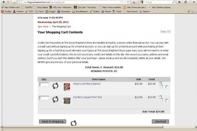

Thanks Linda for this code. This works great on the shopping cart page.
Webkat if here's a snapshot. If you want to know where I added the code I will be glad to show you.

I have a problem, my reward points in the product listing and side boxes and everywhere else is showing as "PRODUCT_REWARD_POINT_TAG" etc.
Not as it should be doing.
I have searched this thread and I have found others who had the same problem got it solved by making sure they had uploaded the files to the correct place. But all the threads are years old and are for older version. But I have tried and it still doesnt work.
The site is Mazda Bongo
Obviously I am using a theme, so im wondering if thats the problem
