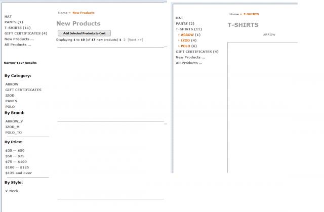

I do not see the top category, but I see it filtered by Brand and Price (This top category does not have any sub-categories.)I do not see the top category, or any other filter in (This has sub-categories.)PHP Code:
index.php?main_page=index&cPath=1
.PHP Code:
index.php?main_page=index&cPath=2
Is there any way to see all the categories including the top category filterable in the side box, in the filter area? As you see it inPHP Code:
index.php?main_page=products_all
There are only various views when you see the category filter.
Products new and products all, probably search (though not got to testing that yet) and manufacturers pages.
There would be no point having filter by category when you are already viewing a category. Similarly on manufacters pages category filter shows but manufacters filter does not.
I think there is a point to it.
Let say you have a top category T-Shirts and you have 20 different brand of T-Shirts as sub-categories. With one of the T-shirt styles being V-Neck.
If you click on the top category T-Shirts, you will get 20 sub-category (brands) below the T-Shirts, under the categories window (in the left Cat window). As it is now.
So how would you filter, if you are looking for v-neck T-shirts among T-shirts->and 20 manufacturer?
Unless I am missing something or doing something wrong, top categories should be filterable also.
Again the filter is being utilized in
andPHP Code:
I don't understand why it can't be invoked in the top categories?PHP Code:
index.php?main_page=products_new
Unless I'm missing something it's sounds like you want it to filter the subcategories. It will only filter products.
Post a link to the site and ill take a look see if I can understand what you mean
I can't it is being tested on a local server.
Screenshot??
Here you go.
Attachment 12001
so you have both brand/manufacturer Arrow AND a category called Arrow??
so when you are at category level you see the sub cat arrow, and there are no products so therefore nothing to filter.
if what you are saying is that you want a filter to be able to filter categories that contain products with Vnecks then thats some serios additional coding and way above my abilty.

A zen site running 1.5.1 is using a link checker to verify his site's link and on the following urls,
http: //Domain.com/index.php?main_page=products_all&disp_order=1&fltCategory[]=19
http: //Domain.com/index.php?main_page=products_all&disp_order=1&fltCategory[]=20
http: //Domain.com/index.php?main_page=products_new&disp_order=6&fltCategory[]=19
http: //Domain.com/index.php?main_page=products_new&disp_order=6&fltCategory[]=20
http: //Domain.com/index.php?main_page=products_new&disp_order=6&fltPrice[]=128.01--178&fltCategory[]=19
http: //Domain.com/index.php?main_page=products_new&disp_order=6&fltPrice[]=128.01--178&fltCategory[]=20
http: //Domain.com/index.php?main_page=products_new&disp_order=6&fltPrice[]=128.01--178&fltCategory[]=21
http: //Domain.com/index.php?main_page=products_new&disp_order=6&fltPrice[]=128.01--178&fltCategory[]=22
http: //Domain.com/index.php?main_page=products_new&disp_order=6&fltPrice[]=128.01--178&fltCategory[]=23
mostly happening on Category[]=19, 20, 21, 22, & 24
he is getting the following warning on lower left hand corner of the page. And the page shows the header info, left category box and the rest is white.
Page displays the same when page is refreshed.
It seems to be coming from the dynamic filter. On this site when selecting New Products or All Products and clicking on any of categories 19, 20, 21, 22, 23 & 24.
Any one with any ideas?
