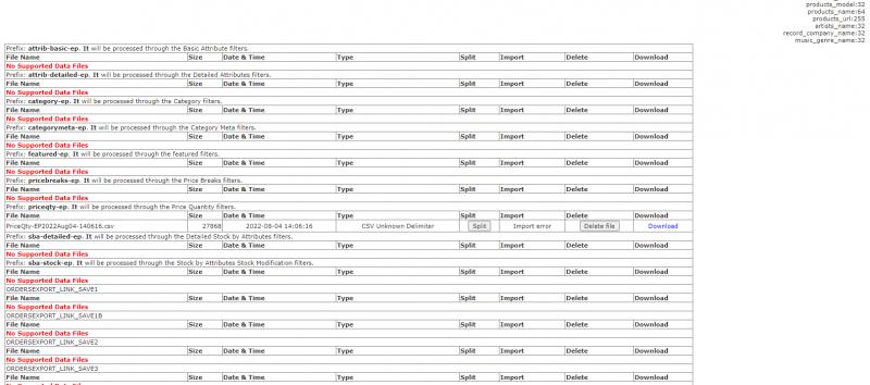

So I just finished removing EP 4.0 and reinstalled the latest from Github. I did not have any luck, same result of not displaying the data from Basic Attributes.....
However.. I tested an older version I have on my hard drive. Specifically Easy Populate 4.0.30 - Beta 06-27-2015 and it worked where all data is now downloading without an issue. The version that was not allowing me to export Basic Attributes is Easy Populate 4.0.37.13 - 05-03-2021

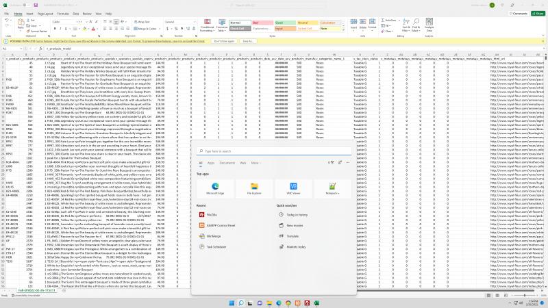

The question remains (for clarity) the detailed attributes export from the same store that is having an issue with the basic attributes export, works or only a single record? Could also identify php version and zen cart version, please? Done any phpmyadmin query testing of the database? I'll go back and try to review such an old version but without understanding why this one is not displaying all of the data for you but is for others makes it difficult to diagnose or claim specifically is a problem with the software, especially when the same software was reported as installed in a different store and reported as fully functional.
JNR345

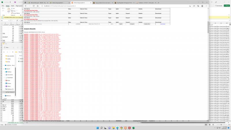

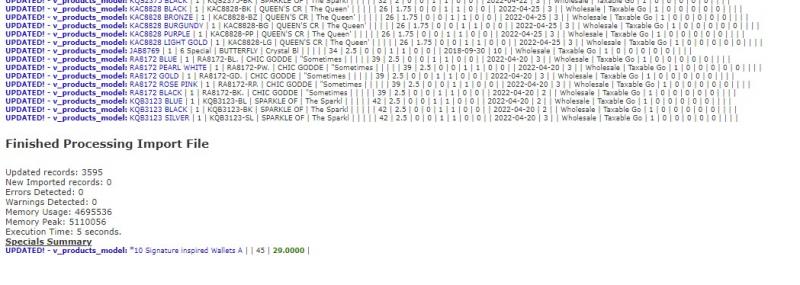

Issue with images ... I've tried everything to figure this out. When using a CSV file with Easy Populate everything works fine but the images remain small when clicking on the "larger image" link. The pop-up will only display a small image. The only way to fix this is through the admin by clicking the edit button for the product, click preview, and then save. That fixes the issue for every item. But why does "Easy Populate" cause this problem with every CSV import? I've tried making the image names and extension lowercase (and lowercase as well in the CSV file) so they all match but it doesn't help. Any ideas?
Only idea(s) that come to mind is that there is some other image handling software that does something when processing through the normal admin. Standard image processing reads the database file location for TY e base product image and then uses the "rules" for images to locate the large, additional, etc. Images for that product. I know that software such as image handler processes an image when it goes through the handler. I can't recall if the user doesn't see the results until the image is loaded a second time or if it's compression is observable on the first visit.
In other words, I have no explanation to why it happens on the site in question as there is nothing that is done that should cause or allow an issue such as that.
I am using php 7.2 and ZC 1.5.7c.
The Detailed Attributes is working without an issue as it exports all data. Basic Attributes exports one line of data. I checked the database and the data is all there and did not see any issue. I have another site that I can run the most recent EP and see if I have a different result, but will likely get that done in the morning.
Thanks for your help. I'm using the latest version of Zen Cart (version 1.5.7c) but this same thing has happened in the previous versions of Zen Cart as well (so which version doesn't seem to matter). Am I the only one experiencing this? So strange, as I've installed several Zen Cart stores and they all do this. I don't have any plugins other than Easy Populate. Why would clicking edit, then preview, and then save fix the problem? That's what I do to every product (hundreds of products). Very frustrating as I'm always importing new products (if I don't, the images remain small and never fix themselves). I think perhaps this problem may be happening to others but they aren't clicking on the "larger image" link so they don't realize the issue. Surely I'm not the only one?
chuckrey
Okay, so when say "all the data is there" what query from EP4 was executed from within phpmyadmin to validate this statement? My question here is if there is a problem with the query or how the data is handled once the query has been executed. Further what about this store is causing a difference than the other store reported to work correctly.
JNR345
So as a "test". If you now export data that includes a product in your previous import and compare the v_products_image path between the two files, what is the difference?
If there are no other plugins installed, the images are loaded to the site via ftp or whatever and the database is updated e by either EP4 or stepping through the product update process, then the fields should be exactly the same and further neither process really does anything with the image itself. The browser on the other hand may operate differently and may require such a process to support sufficient display. What content is in the field space of the CSV file for that image field? It may be possible that "additional" information may be present that interferes with the browser's processing of the HTML. Perhaps could provide a link to one of these updated products that is not behaving properly.
I misunderstood. I checked the data within phpmyadmin but did not run a query, sorry for my confusion. Can you please advise which query I can run and I will share the results?
Also, I checked the easypopulate_4_export.php file and replaced row 222-301 with the following and it worked, all data is showing when processing Basic Attributtes. Of course the code is coming from a previous version of EP4

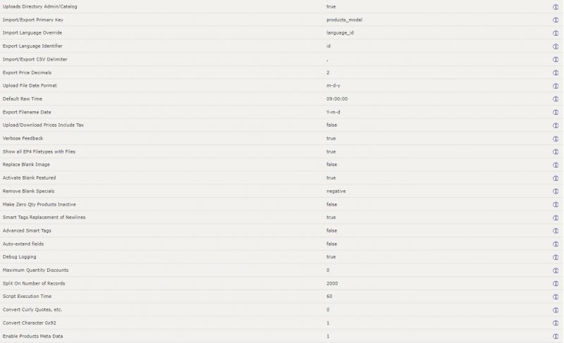

I believe I have found the issue. Please answer at least the below first question. I ask that the second be answered only if the answer to the first is yes.
1. On the other site where EP4 basic attributes were expiring propelling, was the primary key set to the default of products_model?
2. To be answered if the above was yes. What custom field(s) are identified for import/export?
In either case, thank you for reporting this issue. I can see that as>was trying to simplify the code more and also offer additional options that some of the code changes were incomplete for use by the many as compared to the few.

1. - Yes, products_model
2. I am not certain as to which setting you are referring so I am going to send all settings. Sorry.
Uploads Directory - temp/
Uploads Directory Admin/Catalog - true
Import/Export Primary Key - products_model
Import Language Override - language_id
Import/Export CSV Delimiter - ,
Export Language Identifier - id
Export Price Decimals - 2
Upload File Date Format - m-d-y
Default Raw Time - 09:00:00
Export Filename Date - Y-m-d
Upload/Download Prices Include Tax - false
Verbose Feedback - true
Show all EP4 Filetypes with Files - true
Replace Blank Image - false
Activate Blank Featured - true
Remove Blank Specials - negative
Make Zero Qty Products Inactive - false
Smart Tags Replacement of Newlines - true
Advanced Smart Tags - false
Auto-extend fields - false
Debug Logging - true
Maximum Quantity Discounts - 0
Split On Number of Records - 2000
Script Execution Time - 60
Convert Curly Quotes, etc. - 0
Convert Character 0x92 - 1
Enable Products Meta Data - 1
Enable Products Music Data - 0
User Defined Products Fields [this field is blank]
Export URI with Prod and or Cat - 1
Thank you for all your work, EP is a necessity and I am surprised this is not included w/ the install.

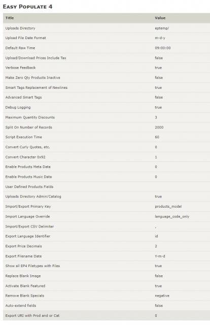

Sorry for the long delay, I was away w/ the family off the grid for a bit.
That is from the site where Basic Attributes was not working for me. Do you need the settings from the other site ?
chuckrey
Please provide the same so that can see if those settings drive a different result on export or if there is another factor to consider. Thank you and no problem on the delay, thank you for taking the time to come back and address.
Here are the settings for the other file.
Maximum Quantity Discounts - 3
User Defined Products Fields -
Export URI with Prod and or Cat - 0

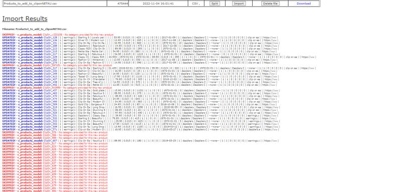

i need help using Easy Populate V4
I am trying copy all my product from one store to another.
Easy populate installation was easy on both store.
I choose Complete product as an export but i am getting an error when trying to upload it to the new store.
The error is and goes for all products:
SKIPPED! - v_products_model: FI66 - No category provided for this new product
SKIPPED! - v_products_model: E8-4812P - No category provided for this new product
SKIPPED! - v_products_model: FI86 - No category provided for this new product
SKIPPED! - v_products_model: FD85 - No category provided for this new product
SKIPPED! - v_products_model: FW89 - No category provided for this new product
However the file has a v_category_name_1 and the new store is entirely blank ( see screenshot)
Any ideas on how to fix this? Thank you for your help

Sigh, let's try this a different way since about the last 5 to 6 pages haven't been read. So the file for input has a category designation that ends with a number. Do you know what that number means or what the significance is about it ending with a number? The number represents the language_id of the language that was exported. Now the program has two features, an import and an export. Each have independent controls. Based on the above description I'm pretty sure I know the cause unless information has been purposely withheld. That said, to learn to fish is better than being fed a fish. So export was fine but having an issue with import. Might there be some configuration settings related to the import that might relate to what is being experienced?
More importantly though.... why are you not using a standard zen Cart process to move and or upgrade the store? Why use any bulk product system to only transfer product to a blank store?
Sorry to make statement in the first paragraph with such tone. The mistake I made in my last upload of the software directly relates to this issue, has been described and discussed multiple times and in my opinion should be something easy to spot as a fix by reading just a few posts. It concerns me when the fix is so simple but takes so much. Yes if I upload a corrected copy it will fix that issue but I'm not really ready because I haven't fixed a separate issue yet that really would need a new version so kind of a waste to issue them in such small groups. Of course instead I talk about it lot... so lose lose in that. Anyways, please do the above homework. Post what you discover or what cannot be found. Glad to help figure things out even if it's something in the instructions. As I said, I took a different approach on trying to address this particular issue of what I expect to be related to my mess up with some settings in my last update.
No offense or hard feelings but this is a really long thread ( over 340 pages )to digest and go thru. It is not really easy to understand or read some of it either.
And no I am not witholding any information.
I thought the error " no categories provided" related to the " category_name" not being provided in the csv file.
I do know and saw what the number 1 means and that is related to the language. My site is not multilingual so i don t think that s the issue.
I honestly thought using easy populate would be a cleaner way of upgrading/switching a store. I should probably go back to the standard upgrade process and leave easy populate alone until it is fixed.
Thanks for taking the timeto look over my issue.
nicksab
Well it can be "foxed" by changing a configuration setting... hence why I asked what the import settings were in the configuration menu... add for reading... so in the works would read a thread that is more than 10 years old from the beginning to the end? Especially if using a recent version of the software? Start towards the back and read at most to the last release of it... if the question still can't be answered, then certainly need to ask.
The error did relate to the categories name. Directly so.
mc12345678,
I owe you a sincere apology and thank you for pointing me in the right direction.
For anyone facing the same issue, the answer is in post #3294
nicksab
mc12345678,
Well thank you. The issue was though described in a way different than those previously reporting the same type of problem and I know full well how it is always desirable for everything to work with zero additional change or adjustment. I still suggest using the standard zen Cart process to "move" the product though really am more concerned about the customer experience, but hope that you are able to accomplish what is needed.

eavinu
So I am happy to say that finally the Unknown CSV Delimiter issue was solved.
I don't know why I didn't try this before...
At first, since this was an upgraded website and had previous versions of EP (1.2....), there was a temp folder in the root and I left it there, changed in the EP4 configuration to false under Uploads directory Admin/Catalog.
Now I decided to move it to the Admin folder and changed the configuration to True and the Unknown CSV Delimiter indication turned to a "CSV ," indication.
Thank you so much for posting this solution!
I had the same problem ("Unknown CSV Delimiter" error although everything looked good to me) and initial setup.
Luckily I found your post, it would have taken me quite a long time to realize it otherwise, since the error message is quite misleading in this case.
marcopm
The real fix can be found in this post: https://www.zen-cart.com/showthread....80#post1385080

I'm running in to the following error.
I am running ZC1.5.7d and Easy Populate 4.0.37.13 - 05-03-2021.
I just did a fresh install (with some mods for a custom product type). (Had problems with the install until I hit the "Install EP4" link but that's another problem :)).
I managed to get the files to be created however, I tried to import the file that was just created and was thrown this error.
[28-Apr-2022 03:13:10 America/New_York] PHP Fatal error: Uncaught Error: Call to undefined function mysql_query() in E:\xampp\htdocs\yyyy\easypopulate_4.php:819
Stack trace:
#0 E:\xampp\htdocs\yyyy\index.php(11): require()
#1 {main}
thrown in E:\xampp\htdocs\yyyy\easypopulate_4.php on line 819
[28-Apr-2022 03:13:10 America/New_York] Request URI: /yyyy/index.php?cmd=easypopulate_4, IP address: 127.0.0.1
--> PHP Fatal error: Uncaught Error: Call to undefined function mysql_query() in E:\xampp\htdocs\yyyy\easypopulate_4.php:819

Easy Populate is working great for me, with the exception of 1 issue. I can not get it to update the metatags_keywords_1 field. I am able to use EP4 to toggle the status (0/1) on the other Metatag fields (v_metatags_products_name_status,v_metatags_title_status) fine. It just seems to be the field where I can enter longer text that is the issue (metatags_keywords_1, metatags_description_1).
We recently upgraded to 1.5.7d and made sure all themes and modules are updated. I am able to manually enter the information for each item, and it does show when I download the store from EP4.
Any thoughts on where to start?
Thanks in advance for any help/thoughts.
Dan
DanMickle
Dan
See if the content at or further referenced back in the following post resolves the issue and please post back: https://www.zen-cart.com/newreply.ph...eply&p=1381450
I went back through those threads and tried a few changes (language ID/Code, etc.) but they did not resolve the issue. I double-checked to make sure the "use products metadata" was enabled as well.
I did also verify because I thought I may have been mistaken when I first attempted a product update. I am able to update the following correctly (as well as the other standard fields):
v_metatags_products_name_status v_metatags_title_status v_metatags_model_status v_metatags_price_status v_metatags_title_tagline_status
however
v_metatags_title_1 v_metatags_keywords_1 v_metatags_description_1
will not update.
Maybe I am missing something in the past posts, so I am going back through them again. Thank you for taking the time and suggesting the post to start with.

To ensure a full understanding, could you please identify the version of EP4 installed and then possibly the configuration settings (don't need to know anything about the path used for the upload/download folder)? Please be specific about identifying the version by its reported value.
Additionally, have you been successful with updating other records that are language based but not Metatag related?
Additionally, have you been successful with updating other records that are language-based but not Metatag related?
I just tested with a record with two language-based (v_products_name_1) and (v_metatags_keywords_1) fields. The products_name_1 worked and the keywords_1 did not.
We are on versions:
- Easy Populate 4.0.37.13 - 05-03-2021
- Zen Cart 1.5.7d
- PHP 7.4.30 (Zend: 3.4.0)
I have attached screenshots.
I just tested with a record using the v_products_name_1 and the v_metatags_keywords_1 fields. The v_products_name_1 updated correctly, and the v_metatags_keywords_1 did not update (field was blank to begin with).
We are currently on version:
Zen Cart 1.5.7d
Screenshots of configs are attached.Attachment 20088Attachment 20089Attachment 20090

Found the issue. Looks like additional effort to support independent update of each Metatag field hadn't been applied. E.g. on the call to minimize the number of columns in an import file or to support update of just one column, this set of data had been overlooked.
In the current code at least the title must be present, but, if all three Metatag fields are not provided, then the missing field(s) will be made blank.
In the interim to that being modified, suggestion is to include the title, description and keywords in the import file. For those that use software to read the content of this forum, the second image above showed an image of the file headers and one example of the attempted content. The headers were: v_products_model, v_products_name_1, and v_metatags_keywords_1.
In the course of this discussion, there has not been a statement that all three were attempted within a single file, so I can only assume that such had not been attempted and that the above is the issue. I have not yet run tests specific to that version and issue with a file that has all three fields that update the database. My response is based on reviewing the code while away from a computer.
That worked like a charm! Thank you firstly for helping and secondly for having me dig deeper before just handing me the answer. The historical info I went over gave me a better picture of how the module (and ZC) works, and that will obviously help in the future. I appreciate all your time and help.
Re: My CSV file uploads the categories, but not the products
v1.5.7d easypopulate 4.0
I am trying to use easypopulate to bulk delete products but am having issues. The process I have used is;
downloaded Model/Price/Qty file
opened the file in open office (OpenCalc)
changed v_status for products showing 0 to 9 (assumption being 9 means delete product)
a) saved file as .odt and uploaded with no result (products did not delete) and no warnings
then
b) saved file as .csv and uploaded with no result (products did not delete) with warning problem with delimiters (??) - in saving as .csv the delimiters selected were comma (,) and double quotes (")
There are no error logs
Have I gone about this the right way or is there a better way to delete products in bulk?
cheers, Mike

update ... as soon as a file is exported it shows up as 'CSV Unknown Delimiter' in the table as an import error in admin/tools/EP4 ... see image ... any ideas as to why?
Attachment 20093

If I had my guess correctly, because when I added the file location protection to the code, I made a mistake about handling files stored in the catalog side of the store and then subsequently the patch provided in this forum was not applied.
This is further described at this post and the link within the quote of that post: https://www.zen-cart.com/showthread....22#post1385422
To be clear, your previous post does or does not still apply? There are other reasons for what may have been seen or described there.
Thanks for your response mc ... I updated admin/easypopulate_4.php with the code from github (using the above and below codes for verification my line numbers varied from that shown in the github but the code snippet was placed ti the correct sequence) .... but there is no change, i.e.
a) file when exported immediately shows in table as per figure previously posted with comment under 'import' tab "CSV Unknown Delimiter", and
b) upon uploading the file with data changes, clicking save in current format (v_status changed from '0' to '9' for about 100 products) this message appears in green across the top of the page "File uploaded Successfully: PriceBreaks-EP2022Aug05-104531.csv Issues with the CSV file delimiter(s)" - the exact same thing occurs in uploading an unmodified file, which would indicate that the exported file is the issue, not anything to do with modifying and reuploading?
c) products are not deleting ... ** the assumption here is that if the file was valid it would automativcally update the database (yes/no?)
downloaded files are opened in Open Office (OpenOffic Calc) and data changed in v_status column only then saved and upoladed. Because I need to change only v_status I have used only these file format requests Model/Price/Qty (with Specials) and Model/Price/Breaks (the latter to determine if the former file request was the issue)
The version installed is the LATEST downloaded from the EP4 plugin page - this is the configuration

The latest file may be present but the updates to that version have not been executed. Obvious because of this line:
Import Language Override: EASYPOPULATE_4_CONFIG_IMPORT_OVERRIDE
In the upper right corner of that screen there should be a link offering to update the installation. After that is done then can talk about other aspects of operation.
So mc - updating the EP4 Database did the trick - for the life of me I didn't see that in any of the readme documents, must have missed it - live and learn I guess.
Again - many thanks for your help.

v1.5.5f with latest version Easy Populate 4.0.37.13 - 05-03-2021
I am trying to import a products file, CSV, which imports, i.e. the file shows on the Admin Easy Populate page and then after clicking the import box I get the green success statement / tick at the top of the page (successfully imported) however none of the data imports - see this error message;
HTML Code:
Import Results
Filename: Products+to+add+to+cliponNETAU.csv
ERROR: Import file does not exist:/home/admin/cliponearrings.net.au/admin/temp/Products+to+add+to+cliponNETAU.csv
Finished Processing Import File
Updated records: 0
New Imported records: 0
Errors Detected: 0
Warnings Detected: 0
Memory Usage: 1247320
Memory Peak: 2422568
Execution Time: 0 seconds.
The file does actually exist in cliponearrings.net.au/admin/temp/Products+to+add+to+cliponNETAU.csv
I am getting a bunch of myDebug-admin errors that all seem to be related to the plugin_support.php - below is an example - the variation between then seems to be the 'line' number
[03-Nov-2022 10:11:16 Australia/Sydney] PHP Notice: CURL error checking plugin versions: in /home/admin/cliponearrings.net.au/includes/functions/plugin_support.php on line 41
[03-Nov-2022 10:11:16 Australia/Sydney] Request URI: /admin/easypopulate_4.php, IP address: 14.201.62.177
#1 trigger_error() called at [/home/admin/cliponearrings.net.au/includes/functions/plugin_support.php:41]
#2 plugin_version_check_for_updates() called at [/home/admin/cliponearrings.net.au/admin/easypopulate_4.php:374]
So needless to say I am stumped
cheers, Mike

many thanks MC ... with filename change I get the file to upload and import but with error 'no category provided for this new item' - the category name column is complete for all entries - there are 194 products in the file, 36 are products that already exist on the site, 158 are 'new products' - the anomoly here is 'new products' - see the summary below. (new products data copied from another file from another site and added to this file - all columns are complete).
Not sure why it is not adding the new products??
Updated records: 36
Errors Detected: 158
Memory Usage: 1318792
Memory Peak: 1728704
Attachment 20142
shags38
Updated records: 36
Attachment 20142
I have guesses, but need more info. Just about anything will help, but first thing that comes to mind is the settings in configuration for the module, then there is a list of the headers of your import file, and then an example of one of these existent field's data.

I'm running ZC 1.5.7d and php 7.4. Everything about EASYPOPULATE looks like it works correctly, except I cannot seem to successfully import the edited changes to the "v_products_name_1" column, which are the product titles.
The import message shows no errors - everything imports, but the product titles don't reflect the edits made to the CSV.
Has anyone else encountered this problem or can suggest where to start looking to resolve this?
Thanks in advance!

There are always a number of reasons that something may have gone wrong. Generally it is because of the configuration of something or another. Best to start with is to show the configuration settings for EP4 and identify the name of the file being used to import
Thank you for the quick reply. These are my Easypopulate settings:
Uploads Directory eptemp/ Info
Upload File Date Format m-d-y Info
Default Raw Time 09:00:00 Info
Upload/Download Prices Include Tax false Info
Verbose Feedback true Info
Make Zero Qty Products Inactive false Info
Smart Tags Replacement of Newlines true Info
Advanced Smart Tags false Info
Debug Logging true Info
Maximum Quantity Discounts 3 Info
Split On Number of Records 2000 Info
Script Execution Time 60 Info
Convert Curly Quotes, etc. 0 Info
Convert Character 0x92 1 Info
Enable Products Meta Data 0 Info
Enable Products Music Data 0 Info
User Defined Products Fields Info
Uploads Directory Admin/Catalog true Info
Import/Export Primary Key products_model Info
Import Language Override language_code_only Info
Import/Export CSV Delimiter , Info
Export Language Identifier id Info
Export Price Decimals 2 Info
Export Filename Date Y-m-d Info
Show all EP4 Filetypes with Files true Info
Replace Blank Image false Info
Activate Blank Featured true Info
Remove Blank Specials negative Info
Auto-extend fields false Info
Export URI with Prod and or Cat 0
Attachment 20168

I should have expanded my original post and explain that the other numerical fields in the CSV, such as product weight, and stock quantity, can update via EASYPOPULATE successfully when I modify these values in the CSV. The only field that doesn't update, and does not show any error or warning messages after import is the v_products_name_1 field.
It normally also helps to also know what other fields are in the import file, but I already can sort the issue based on the five or six ways that it has been described over as many or more page threads.
Change: Import Language Override language_code_only Info
Literally to any other value. Right now it only imports language type fields that are provided using the two letter language code. What is provided in your import file is the language field using the language_id. As recently described to chadderuski (basically the original developer of EP4) there is an alignment to be had between what is to be imported and what is allowed to be imported. I changed the plan on mid distribution development. The default setting for that option should have been: language_id_only.
Thank you! This worked. Sorry, I should have poured over the thread more carefully since the solution has already been talked about.

Understand. For confirmation are you able to tell the difference between red and green? The code change to the Zen Cart 1.5 8 software needed for operation is at this link: https://github.com/zencart/zencart/pull/5486/files
The first highlighted text is red and has a dash of negative sign on the left side. That is what is the "problem" below that is green text with a plus. That is the code needed.
I can describe differently if still request.
Friends, I'm using version v1.5.5e. (yeah, I know...) but I have like 50 sites and upgrading is going to be a massive undertaking, so I'm still there. Until a few days ago, this mod worked perfectly, has worked perfectly for years. Now I'm getting this error each time I choose "easy populate 4" from my tools menu:
Attachment 20202
Any ideas what may have changed on my hosting server perhaps? This behavior is consistent across ALL of my sites, and has been this way for several days. Everything else is working fine on the site.

The issue, based on your description is with the second problem identified in the previous discussion. It comes down to alignment of import language identifiers as compared to what the file contains. Your file has the language id (1), but the default install/upgrade for import incorrectly sets to language_code_only. This means that if a file had for example: categories_name_1 and categories_name_en columns, then only the data in categories_name_en would be imported. Not having that column in a default install causes no category names being found.
So, change the setting to literally anything else (recommendation is language_id_only) and that problem will be resolved. The issue quoted above about that file is in reference to the original distribution of Zen Cart 1.5.8.
Thank you for this fix! :)

or b) can someone give me a hint as to how to do this please, what file etc.
many thanks, Mike
Sorry for the late response, your fixed worked ... many thanks!!!
HTTP error 500 when going to admin page/tools/Easy Populate 4.
I hope this is the correct place to post...been out of the game for 7-9 years and slowly working my way back in again....I uploaded all the files as stated in the install file and now I get a HTTP error 500 and easy populate does not show up under the configuration tab.
Running zencart 1.5.8
MySQL 5.7.23-23
Linux 4.19.150
PHP 7.4.33
Please help....

Please take a moment to read the very recent previous posts. Should not have to read many more than 10.
I'll look more closely again...most of the posts i looked at had to do with people being able to access EP, but then having errors...i can't even access EP after clicking on it under tools...Letcha know what I find. Thank you for the push in the right direction MC
jtlswan
My how time flies. It is a few more than 10 posts back, but not by many as the same issue(s) seem to appear at least once per page of postings. The most summarized post of known issues which includes yours is: https://www.zen-cart.com/showthread....28#post1392328
I don’t know how you deal with idiots like me and keep your composure/patience. It worked. Thank you very very much! All in a days work for Superman MC
jtlswan
I appreciate the credit, though have not 100% remained so composed. I'm human and have my moments. Thank you though.

Good news MC...it still working...thank you Sir...now, bad news...I'm sure I'm being a dumbass again and getting an upload error: SKIPPED! - v_products_model: gwpuldvd1361 - No category provided for this new product...
Obviously I have a category (categories) in the csv file:
v_products_model v_products_image v_products_name_1 v_categories_name_1
gwdvd103428 gwdvd103428.jpg DVD - Back to the Future Miscellaneous^Discontinued Items
ideas?
jtlswan
ideas?
Well as this is the last post of this page, for those listing 10 posts per page, groundhog day begins on the next post. The issue described above is the "second" issue with the current version of EP4. Please follow the guidance from the above link about ensuring the import of language dependent fields matches the filename fields. It is discussed in the thread previously shared where the statement was that there are two known issues. It looks like you've resolved the 1.5.8 issue, now the other one.
