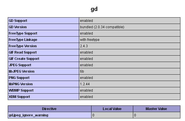

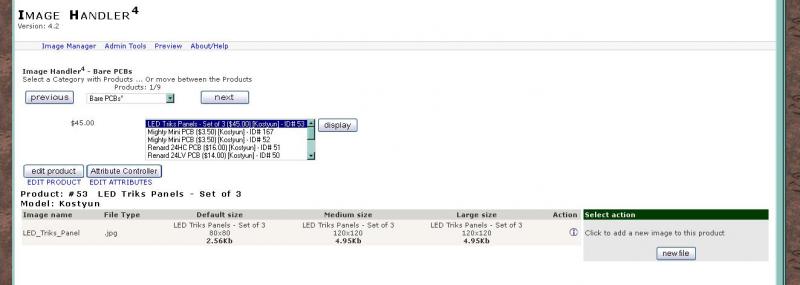

Help required please.
I am into Day 3 of trying to configure IH4. I've refrained from posting questions, but now could do with some help.
I have resorted to a completely fresh install of ZC 1.5.1, including example categories and products.
I have not created a custom template. Everything is out of the box.
My GD Version (described in php info) is: "bundled (2.0.34 compatible)"
I have read through the installation instructions and installed as described (Route 1, following "New Installation Instructions").
Messages at top of Admin indicated successful install. I also deleted the file indicated in the last line of the messages.
Both IH4 Admin pages look as they should:
Admin > Catalog > Categories/Products
Admin > Tools > Image Handler4
I changed IH resize images to "yes".
From the Configuration tab, I followed the instructions in the "Zooming (fancy hover effect)" section, removing all heights for the image settings, as you have, and replacing the width = 100 settings with width = 50 (so I could see a difference in image size for the hover behaviour).
Other changes:
Product Info - Image Width = 97 (so I can check that the change is effected in the browser)
My problemn is that I don't see any larger images (or indeed anything happening at all) when I hover over small images in pages such as "All Products" or "New Products".
If I click one of these small images, I get the product info page, with the 97px wide image, as expected. Click on that and I get a rather ugly default ZC popup window with a 200px wide image (where does this dimension come from?).
Can anyone suggest what I need to do to enable my images-on-hover?

Only the category "bracelets" can be choosed, the others are invalid. As what you can see on my store, all of the products of every category can show very well. The link:www.moimoii.com
Attachment 12449

Great.. now can you save me the trouble of rooting around your store and randomly clicking on links looking for stuff please??:lookaroun Please provide what I asked for before and post links to SPECIFIC PRODUCTS IN YOUR STORE where you see the issue and then post links to SPECIFIC PRODUCTS IN YOUR STORE where you don't have the issue.. Screen prints of your admin are not very helpful...A
lso you can only CHOOSE categories with an asterisk next to them.. So you can CHOOSE "Drops", but not "Earrings"

Understood what the problem is.. I asked for the links because it's possible that your image names or category/product names might be an issue, but since you aren't giving me the information I asked for let me summarize this way.. Your issue has several possible causes:
- Invalid image or product category names
- Image Handler is not installed correctly (missing files, other mods you installed which modified the same files as IH4 not merged correctly)
So you will need to go back and check these things.. IH4 out the box installs with no issues.. It doesn't have an issue which would lead to the problem you are describing unless one of these factors is in play.. The most common cause of issues usually lies in an incorrect install..

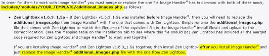

Hi,Divavocals
I have a question about installing zen lightbox after IH. In Misc of IH instruction, you said "just replace the Image Handler4 additional_images.php file with the one from Zen Lightbox". Which additional_images.php should I replace with the one from zen lightbox? There is no additional_images.php file in includes/modules/YOUR_TEMPLATE/ after installing IH. Or I just copy zen lightbox installing files to my server and there is no need to do another "replace"?

I there is no includes/modules/YOUR_TEMPLATE/ after installing IH4 then IH4 is not installed correctly.. Before you install the lightbox mod, you need to get IH4 installed correctly..
Re: Image Handler 4 Support Thread (BEFORE YOU POST A SUPPORT QUESTION HERE)
DivaVocals
I installed IH as soon as I finished ZC 1.5.1 installation and I tried that twice at the local and my server. The admin confirmed successful installing for both and IH works very well so far. But I really can't find includes/modules/YOUR_TEMPLATE/ untill installed zen lightbox which has includes/modules/YOUR_TEMPLATE/ in its installing folder.
I'm just confused if IH installation will creat a includes/modules/YOUR_TEMPLATE/. You know there is no includes/modules/YOUR_TEMPLATE/ in IH's installing folder and the instruction don't ask us to rename or creat aincludes/modules/YOUR_TEMPLATE/.

Please review the instructions.. Items 6 & 7 cover these files and their location in the IH4 fileset, and it covers what to do with these files.. Again, if you do NOT have a "/includes/modules/YOUR_TEMPLATE/additional_images.php" file in place after installing IH4, then you do not have this installed correctly..
(copy ALL of the add-on files to your store!! Most issues are caused by store owners who decide to NOT load ALL of the module files)
DivaVocals

Hi DV and friends
I was hoping not to have to post here :-( I've read, read again, scratched, read again to be sure, tweaked, uploaded, flicked on, off, etc etc and cannot get this working as expected.
I've installed IH4 using defaults on a developing Zen v1.5.1 install. No conflicts with files of note (one or two that were never modified-overwritten with IH4 versions). Several add-ons installed but nothing directly affecting images yet--seemed wise for IH4 to be the first and base for image related add-ons. IIRC/AFAIK, I'm not using any jscript or such with the add-ons.
Previously (with existing store) I've generated all images and uploaded to respective directories; ../images/nameX../ ../medium/nameX/.. ../large/nameX/.. for each manufacturer and used suffixes; _m, _l for medium and large versions. All .jpg. EP for bulk/mass product manipulation. FTP for images uploads. Almost all products (1'000's) have images and most have multiple images, sometimes up to 10.
For testing purposes on this new v1.5.1 install, I just dumped a few 'handfuls' of the small images for a few manufacturers. All working as expected.
For testing IH4, I have uploaded renamed large images directly to the relative images directory. Full size but no suffix.
Problem scenario 1:
1. No additional images (thumbnails) displayed despite images present - both existing and one or two products where I have specified/uploaded images via IH4 tools (not an option for me going forward, btw - not feasible for the number of images I deal with regularly).
2. Watermark on large image only (should be medium too)
3. No hover effects
Image - Use Proportional Images on Products and Categories = 1
For this test product...
- Full size images (x3) in 'small' directory i.e., ../images/nameX/
- No images of same name/model in 'medium' and 'large' directories.
Now, before you jump... the following configuration setting changes things...
Image - Use Proportional Images on Products and Categories = 0
SAME - Full size images (x3) in 'small' directory i.e., ../images/nameX/
SAME - No images of same name/model in 'medium' and 'large' directories.
1. Additional images present (full size displays on click too)
2. No watermarks
3. No hover effects
4. Medium image reduced quality compared to previous settings (crisp but not smooth lines). Thumbnail images also a little more jagged than expected (crisp but not smooth lines).
5. Medium image on click displays blank pop-up window i.e., no large image.
Other config settings...
Originally had my previous settings for small and medium sizes set (e.g., 100x80, etc) but now have used your example config settings (width only for small, medium and large [1200 for large]) and exactly the same result.
[edit: GD 2.0.34 installed according to server info]
I intended to write up other scenario details but my head is spinning now reproducing the settings and documenting the results.:wacko:
I have my fingers-crossed that you will be able to say 'Oh, flick this and click that... and all will be good', but I don't have much faith in that. ;-)
GAM

No Images in Admin and no Popups
I have my new site up and working so I thought it was time to get my images in order. I have a local version of my site that I test on so I cannot give you a link to it. The details of the setup are below.
Zencart Version: 1.5.1
Template: Abbington Mega
Addons: FEC, CSS/JS Loader, Image Handler 4 Install Method 1
Local Host: XAMPP 1.7.4
Image Manger in Admin
Attachment 12609
GD Info from phpinfo
Attachment 12610
I have gone through all the files as you would in Install Method 2 and found nothing that I "SEE" to be wrong. My admin shows no images and I am not getting any popups when I hover. Basically the settings and menus in the admin appear to be correct...but nothing works. I am baffled. After going through the instructions for the 6th time, I cannot see anything that I missed. Any input is greatly appreciated.

I am using ZC V1.5. After using Image Handler for over a year, I am suddenly getting
Image Handler4
No Image Handler information found.
Image Manager
Admin Tools
Preview
About/Help
Uninstall Image Handler. (Please backup your site and database first)
Clear image cache
Scan for old IH 0.x and 1.x original images
I cleared the cache, but still get the same as the above.
All of the previously loaded images still work as they should.
Do I have to uninstall IH4, and reinstall? If so, do I have to upload all of the images again?

Further information:
When I first open Image Handler, the above appears.
If I click on Image Manager, the first category appears as per normal. This category is working.
If I try to go to another category, the screen appears as in my OP.
coopco
Yep.. should fix things..
coopco
Nope..
DivaVocals
Yep.. should fix things.. Nope..
OK, thank you for answering.
Just to let you know that the uninstall and install went like a dream and all is now well again in my shop. I also took the opportunity to install the latest version.
Thanks again for the great contribution.
