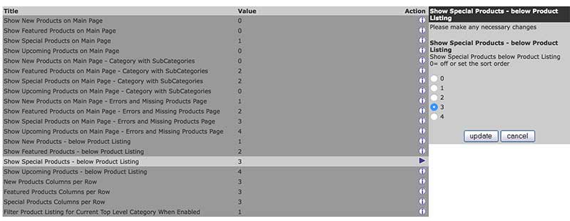

Specials on Main Page of Site.
Is there a way to Turn on Specials on the main page of the site template?
Thanks for the quick reply.. I have changed the settings and still nothing..
Could I have done something to the index root page to stop that from showing up?

Specials are still not showing up and I think I am choosing the wrong numbers for them to display. All I want is specials on the main page.

I'm trying to get the products to show up with 5 items to a row. I've gone through all listing, featured, specials and anywhere I could look and can't seem to get it to change to 5 items. Is there some parameter (such as image size) that would stop this from changing?
http://www.bikerschrome.com
If you want specials, featured, and new to have 5 columns you need to set it in admin--configuration--index listing.
Find line 516 in the stylesheet.css file and remove these rules:
Love your logo, btw :smile:Code:padding:20px 0px;
width:30% !important;
margin-left:15px;

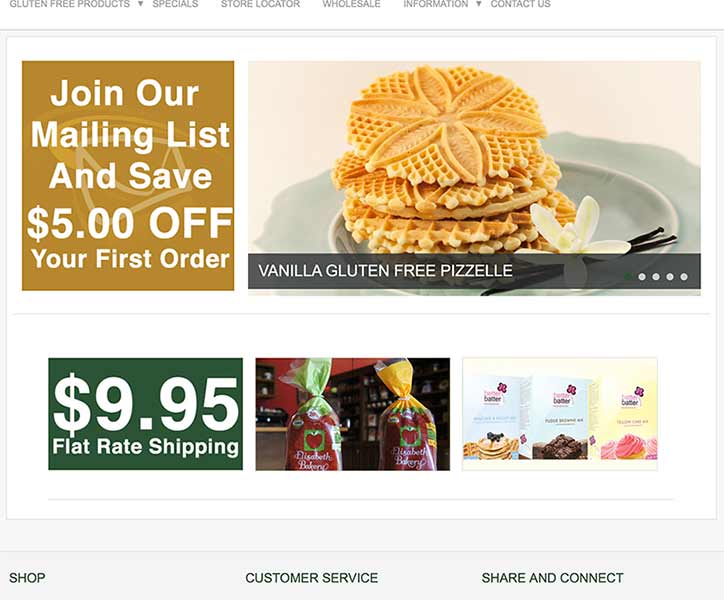

I'm trying to adjust the site above the fold and make it more active. (May or may not be a good idea)
I'm trying the make the home page slide shorter. I looked in template config as well as banners and couldn't find it. I also adjusted the image size. Didn't work.
Could you straighten me out?
