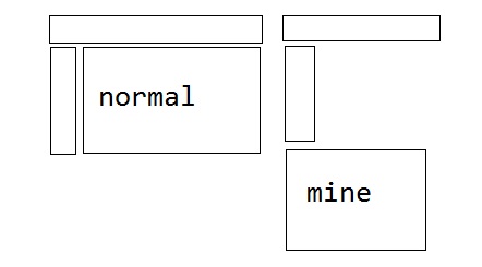

Sitting here for a while, trying to figure out what is going wrong.
I have searched for it, but nothing comes up, or maybe i'm using wrong search words.
Empty categories show nicely (there is nothing there)
But, catagories with products in it, show up wrong.
I have the dynamic filters on the left (and sometimes I switch on the categories left sidebox too)
Normaly the content/products is/are in the middle, but mine now is under the left sidebox.
Like this
Attachment 15158
What could be wrong here?
I don't believe SBA affects the display of categories and is probably not associated withthe installation of SBA; however, the sidebox that you have that includes dynamic filters. Might want to double check your logs directory to see if there are any myDEBUG files.
I double checked but this addon didn't make any productlisting changes.
I also don't have logs that say anything.
Could it be the dynamic filter that is causing the problem? But then, i had that in for a couple off days and didn't have this problem then.
Pompidompie
If your seeing all of the expected content, then more than likely the issue is related to a CSS file... Those issues can be helped with when providing a link to the page(s) having a problem. They can be self diagnosed when using tools such as firebug with firefox or web developer for the same, or similar tools with other browsers.
I will say this, dynamic filters is one of the plugins that are still under review to ensure functionality with SBA (really it's the reverse to ensure that SBA properly supports dynamic filters, though some union may have to occur between the two).
Will it help if I show you the pagecode? (mouse on the website, right mouseclick, show code)
It's a big mess because i'm still building, but maybe it will tell us something?
I am looking at the stylesheet (i have chrome elements) but i haven't found anything yet.
If i remove the % witdh of the onerow.fluid in te responcive.css the categories with nothing in it, also move to under the sidebox.
Makes you think, lets reverse that. If they can move over there, the other categories can move back up. But no. The haven't got a % witdh, they have a px width and no matter what i changes, they don't move back up.
Going to puzzel some more....
I had looked everywhere. Gave up for today. Started to read the Attribute Stock Setup and trying to add a product.
Doing stuff in the admin and checking it in the catalog. And heeee... adding a product did the trick. It moved my products back up again :thumbsup:
Pompidompie
That my dir sir (mam), would be an indication of a template issue. Suggest all future issues with that problem be addressed in the forum of your template.
Glad though that at least for now the problem is solved.

Hopefully it is just a simple setting that I'm over looking, and appreciate any help anyone can provide!!
Good detail. One small one that may have been overlooked (some reason it hides so well...) Check the dynamic dropdowns configuration section. That is from where the notifications that you are seeing are controlled. The identification (left/right/neither) of the product being out-of-stock as well as a couple of other settings.
If don't want to have any indication of stock quantities on the product page, could turn off dynamic dropdowns entirely and the customer will not be made known of any stock related options until the product is added to the cart and attributes will be presented as originally "chosen" without a sequencing requirement.
Genius! I never noticed the dynamic dropdowns menu, it was so "hidden" lol! So far I think the few tinkers with those options fixed my issue!! Thanks so much! I'll let you know if any other anomalies creep in, since I'm sure there are other option menus I'm totally overlooking!
