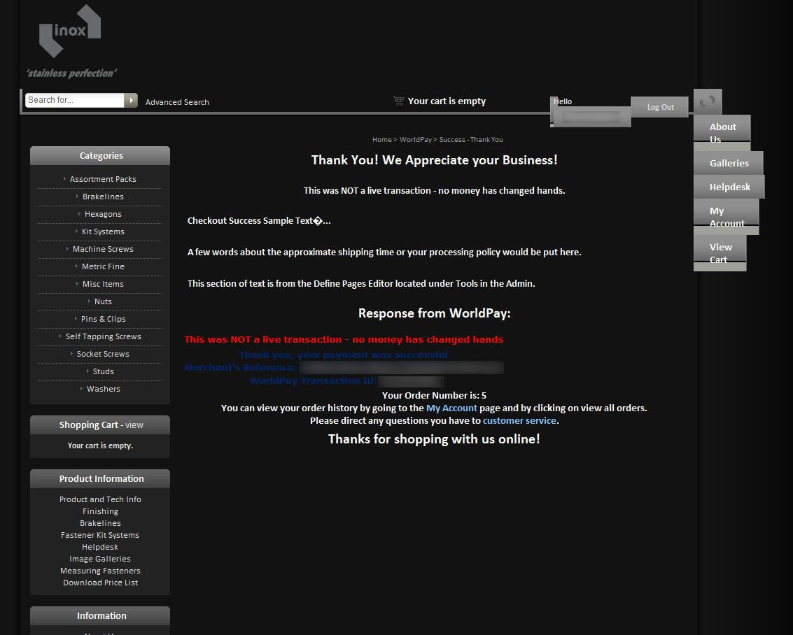

Re: WorldPay Module version 2.0 - Support thread
Hi peeps,
I have looked through this thread over a few days and can't seem to find what I am looking for. I have also been back and forth with Worldpay support team and they have been helpful, but the issue isnt solved.
Basically, I have the whole site ready to go, the worldpay integration works well, payments go through, orders added back into zen cart admin area, emails all go out, but... the callback is apparently working fine, worldpay guys say its fine, but there is apparently some problem on zen side displaying the page that says: thanks for your order, etc...
the rest of the callback part works fine, I have my header, navigation, footer, links, images, etc... except there is a big main body blank area that says nothing.
any ideas? :huh:
thanks in advance

Suekay
I solved the problem by upgrading :clap: :oops: but when I tried a live transaction - (which worked) the thank you page had missing information. I pasted the following from the internet page into WORD:
Thank you, your payment was successful
Merchant's Reference:
RBS WorldPay Transaction ID:
So the Merchant Ref and Transaction ID is missing.
BUT on pasting it from WORD to here the Merchant Ref appeared!!!! (Obviously I have deleted it again now.) I checked it wasn't hidden in a white font in WORD. The transaction ID didn't mysteriously appear though!
Anyone had this problem and solved it?
Thanks SueKay

Hi peeps,
any ideas? :huh:
thanks in advance
I had a blank page when I'd changed a line of code by hand instead of upgrading - all I can say is double and triple check you have all the files uploaded.

Hi Suekay,
I can actually view the success page separately through manually typing a link to it, so I know its there, just cant tell why its not showing up?
this is the only thing stopping the site from going live :-(

Hi Suekay,
Anoth thing that I learnt whilst installing mine was to wait. I had mine in test mode, then changed to live, but it didn;t work. I had to wait for the WPay system to update and after a couple of days it started working by itself. Sorry I can't offer you any better advise.

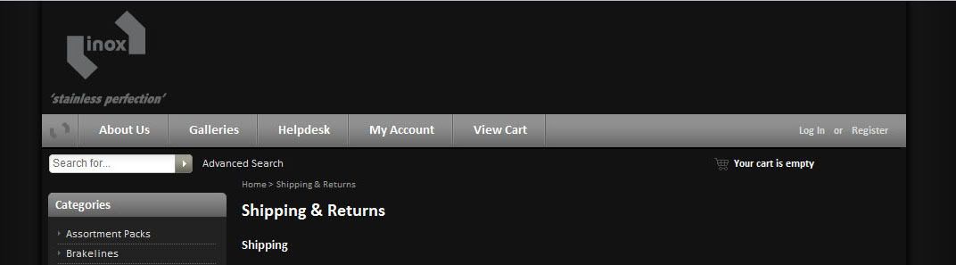

Hello there.
Completely new to this and really struggling getting this module working.
I'm adding this to a store that is on version 1.37.
I have uploaded all of the files.
I've got all of the login information for the worldpay admin area and the store admin area.
First of all, I activated the module from the payments -> module option.
Then I proceded to follow the instructions for both the store admin and the worldpay admin.
With regards to the worldpay side of things, when I login, I can choose to go to the 'Production Merchant Interface' or a 'Test Merchant Interface'. No idea which one I should be editing, if someone can tell me, that would be great. Within each one under Installations, is an Integration Setup for Test and Production, again, not sure which one to modify here.
I thought I would try and edit the admin side of the store with the settings for the module, but when I enter anything and save, it doesn't seem to pick up any of the information I've entered. Things like Installation ID, MD5 settings etc are all lost when I press save.
Can anyone please help a complete newbie?
THanks so much in advance,
Craig
webchills
Did you find a solution for this?
Hi Webchills,
Maybe a long bow here, but I had hassles with the callback page. Turned out that the Worldpay servers had a problem parsing if your callback page had divs that DIDN'T have whitespace between tags.
ie <this div><didn;t work>
<this div> <did work>
When I manually inserted whitespace between the divs my callback page went from looking like a dog's dinner to perfect display.
FEQ
Hi Webchills,
Thanks! I finally found the <div>.
I saw your posting some pages before but did not find any suspicious divs.
Turned out that there was a
<div class="clearBoth"></div>
in my header.
Bye bye dog' s dinner :-)

This is a little bit of a long shot, but I haven't been able to work it out on my own thus far and this is one of the last things I need to sort out to get a site live.
I'm running Zen Cart 1.3.8a with this template http://www.zen-cart.com/index.php?ma...oducts_id=1740
It seems that something is breaking the template on the worldpay successful payment page, but I haven't been able to work out what it is and how to correct it.
This is what the broken page looks like:
http://i101.photobucket.com/albums/m...entemplate.jpg
And this is what the top of a normal page looks like:
http://i101.photobucket.com/albums/m...template-1.jpg
I note that it has centered all of the text in my left menus as well, so maybe whatever is causing that to happen is also breaking the layout of the top navigation?
So I guess what I'm asking really is how worldpay pulls through this template page and how does it decide to display it. I feel like with a bit more information I could probably work something out on my own, but at the moment I've hit a bit of a wall with it.
Well, I ended up using the overrides idea mentioned earlier in the thread (it took a while of trawling through) here - http://www.zen-cart.com/forum/showpo...&postcount=384
Used that to disable the top navigation for the call back pages, which makes them look much more acceptable.

I can confirm I now have the code working with zen-cart v1.5.1. I believe it was a problem with some of the session settings as pointed out by philip clarke a while back. I did a clean install of zen cart and the worldpay module again before figuring this one out.
I have made a few minor layout tweaks to get this to display correctly on my site and obviously changed the worldpay urls.
I did contact philip and he was available to respond (if anyone else needs him - he's available for a small fee) but I managed to get it up and running before he had to mess with the code.
I have noticed a few minor bugs such as this supposedly being v2.10 and it only showing as v2.09 in admin etc... I've also changed my side box card icons to some I have hosted locally (as ther others were ugly and to a set size).

Hi all,
I'm pleased to announce that I've had the code updated by Philip, he was lurking on the freelancer.com site where I was advertising for help.
I've submitted an updated version of the module for zencart v1.3.x to the add-ons area. This should hopefully be approved and appear in the next week or so.
I have a copy of the module working on 1.5.1 but its had quite a bit of code changes as the admin area side of things didn't work and has been made bespoke for my site (since I was paying for it). I'm sure he will have a stock copy of this available for anyone who requires it.
If anyone needs any help, let me know!
