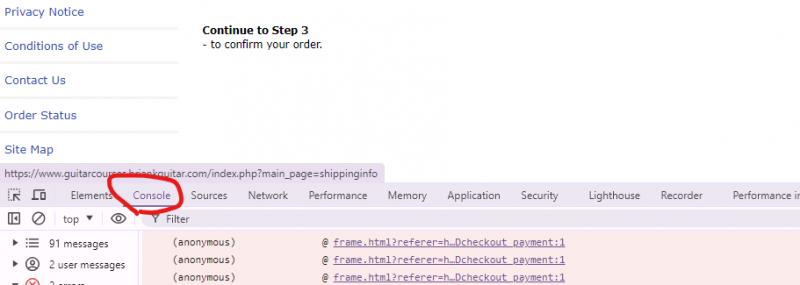

the fact that you are not seeing any logs does not mean they are not out there. have you generated any other logs?
more likely you may be having a javascript issue. i would suggest opening developer tools and looking at the console, perhaps there is some information there.

take a screenshot of when it hangs.
No modifications to checkout steps or required feilds... I left it stock/out of the box for that... besides, I figure ZC would want to draw from that info for payment gateway purposes... billing info etc.. The only "mods" performed were for relocating the downloads folder... made the necessary changes to the configure.php files so that those files can be read/located... that all works as it should... I haven't "changed any other stock functions in Zen other than that
Yes, I will take a screen shot of when checkout hangs on Step 2 of 3" :thumbsup:

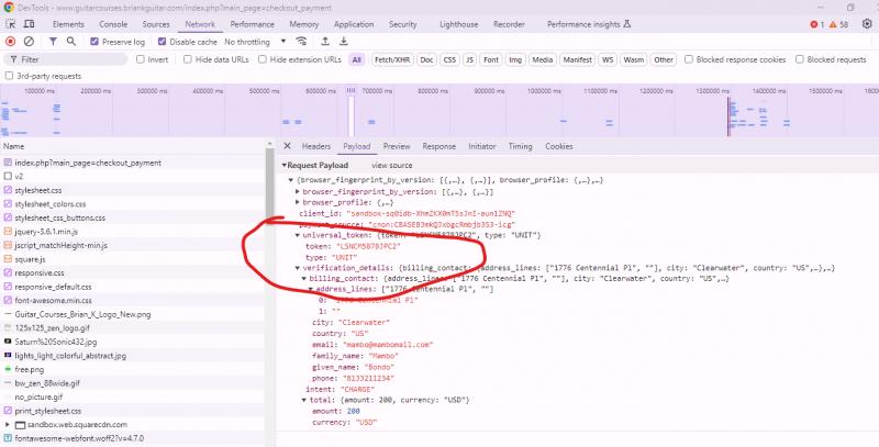

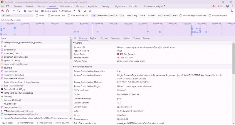

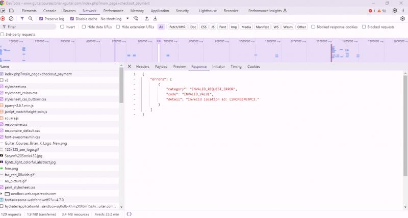

Some more information on this problem...
I want to mention @OJ_SIMON and thank him out here on the thread for his help with this. He has been kind enough to do some investigating in areas I don't know too much about and has found the "error" message that points to the problem. There's a few screenshots attached that give the error and what is causing it but, as of right now it's up in the air as to where exactly the problem is occurring.
The token info hs been checked to see if the issue/error was occuring there but, the token info appears to NOT be the source of the problem.. it appears to be somewhere else...
That's all on this as of yet.. any isnights, suggestion on where else to look is greatly appreciated :cheers:

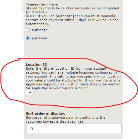

what have you got set here:
Attachment 20692
That's a good question... for locations in sandbox at square it is a default location for seller test account however there's no way to enter that code via the pluging.. there is that little arrow but when I mouse click it there is no feild that opens for anything to be entered into it... not sure how to add a location code there :no:
There is a location that is connected though.. when I look at the plugin information before opening it it is connected to a location associated with my square account...
I did create a new location in my square account just for this store but I have no way to edit that info for the plugin... I would think it shoudn't matter... I should still be able to make transactions...
you don't add it yourself it is retrieved from square by API based from the other information (So I would of thought even in sandbox the API would draw in the sandbox location ID and fill that dropdown.
have you added your live details ie key ect.. and dose this list get filled when you turn off sandbox?
If I'm understanding what you're saying is do I have the the OAuth Application ID and Secret information enetered... yes, I gave that in those feild.. to go Production Mode with the application I would enter that information and it will switch out of sandbaox and be live for actual (real) transactions to be processed...
When I go to Production Mode I do have a dropdown menu which allow to choose which location to use... I take this as a good sign... when I switch back to sandbox by enetering those credentials the location ID stays the same as what was previously chosen for the production mode's location and there is no longer the ability to choose a location any longer... no drop down menu in sandbox mode... Don't know if this matters or not..

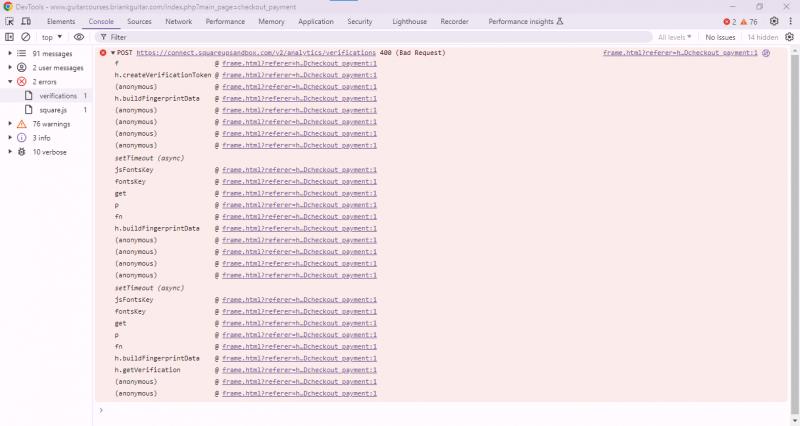

Checkout still hangs at Step 2 of 3... screenshot attached... same error 400
Attachment 20693Attachment 20694
More Console info FWIW...
index.php?main_page=checkout_payment:824 A parser-blocking, cross site (i.e. different eTLD+1) script, https://pan.zen-cart.com/display/gro...rd=55682736003, is invoked via document.write. The network request for this script MAY be blocked by the browser in this or a future page load due to poor network connectivity. If blocked in this page load, it will be confirmed in a subsequent console message. See https://www.chromestatus.com/feature/5718547946799104 for more details.
square.js:3 using standard paymentSubmit button
connect.squareupsand…ics/verifications:1
Failed to load resource: the server responded with a status of 400 ()
square.js:3 An issue occurred while verifying the buyer
The time to complete the verification has expired: verify-buyer-892-12956.874308824885
