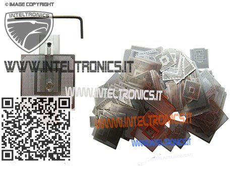

Hello,.
Thank You for image handlet update, very simple to install and usefull,
for who is interested in, i have used in my watermark a QR Bar code, look photo attached,
so from this site http://qrcode.kaywa.com you can generate a barcode and encrypt whatever information you want included copyright info and after can paste bar code image on you water mark, is enugh a mobile phone with barcode reader and you can read information that contain the bar code
Wbr, Carmelo.
Attachment 10595
