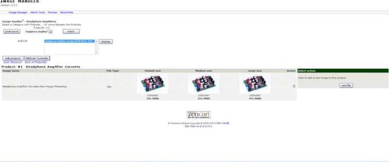

To answer your send question about the delete button, I am attaching a screenshot:
Attachment 12954

Can't see this screenprint.. a yes or no response was all that was needed..
I suggest deleting the image and re-uploading it, and tell us what happens..

No, there is no delete button immediately below images. The whole horizontal area from the left of the screen to the right is a clickable hyperlink. If I click on the hyperlink (or any of the three images), then I am presented with three buttons - edit, delete, and new file.
I already deleted and re uploaded image several times. The result is the same - all three images are of the same size.

So I went back to the a week old backup of the site and database and installed them on the server. I imported the database that existed week ago into the new database because the old database does not exist any longer, as I several times tried to install a fresh ZC with only IH4 added.
After the installation, I logged on to the IH4 and I saw three images (small, medium, and large) being there and all having different sizes. I thought, well the problem is solved.
But, when I tried to remove the image and upload it again to make sure that the IH4 functions properly, the IH4 uploaded all three images with the same size of 191K.
At the the time of this installation one week ago, I had only two products and each product had one image. As I mentioned above, I removed image for one product, while retaining the image for the other product. The product which has newly uploaded image has all three sizes equal to 191K. The product which has image uploaded one week ago has three images of different size, as it suppose to be.
Re: Image Handler 4 (for v1.5.x) Support Thread
EHSI
Looking at your site from the link a few posts up, it doesn't look like it is using IH. When you view the image that is displayed on the page, it is not a resized image in the bmz-cache folder, but just the base image in the images folder (default ZC behavior) with height and width changed in the <img> tag.
Can you confirm that you have gone to Configuration->Images in the admin and set "IH Resize Images" to "yes?"
weif
BTW, I have found that the absence of the bmz_cache folder as part of the path is not a pure indicator that IH is not activated. I have found that it is possible to have the original filename and path if the original image dimension(s) are smaller than the max dimensions identified in IH; however, even in that case because the dimensions for the other two file types are smaller than the saved file the three files do show as having different file sizes.
But as said, the "large" file name does not show bmz_cache as part of the filename.

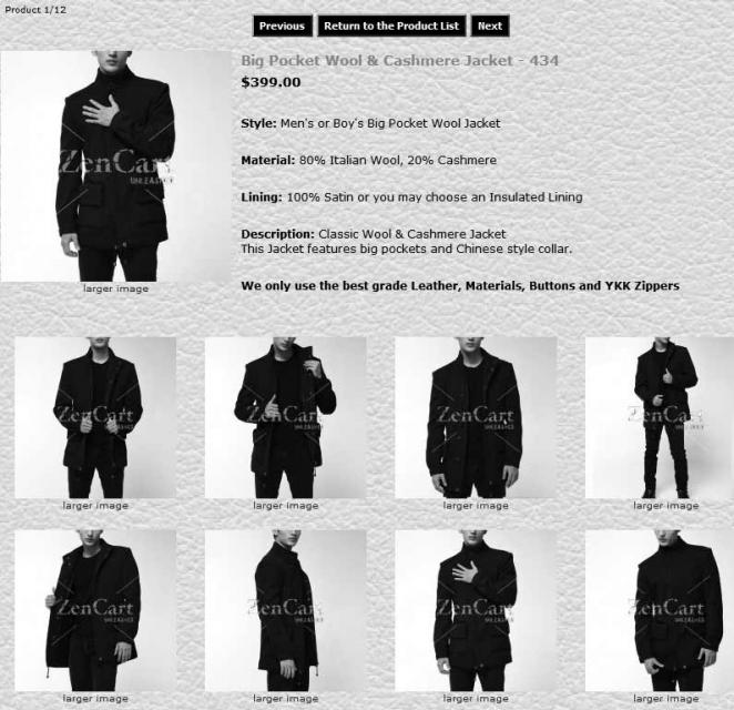

I am running v1.5.1
I have I installed and running fine except one small thing which isn't exactly a hugh problem just more of a annoyance.
When you click on the product image and it brings the item up in the lightbox (Zen light box also installed) there are 2 images in the slide show but both are identical
gazag
I am running v1.5.1
a link to you site to SEE what you are referring to would help.. but this sounds like a LIGHTBOX issue and not an IH4 issue..

Sorry www(dot)lime light store(dot)com remove spaces and (dot)s
gazag
FYI, if you are worried about you site being indexed, the spaces aren't necessary.. Simply typing in www(dot)limelightstore(dot)com is plenty to prevent the site from being indexed.. (makes it easier for community members to copy your URL)
Anyway if you are referring to the main image being repeated, this is NOT an IH4 issue.. It's a lightbox issue, and you need to go to the Zen Lightbox thread where lucky for you I just posted the solution for the problem. You will need to wade through a BUNCH of other posts.. Ignore them.. just focus in on MY posts.. Go back about 3 or 4 pages and wade your way forward..

THANKS:smile: that was a quick and easy fix. One more quick question - i have v1.5.1 and version IH4.3.1 installed do the security fixes found in the following posts still apply? Because my files look a lot different to what is posted....

Images displaying in my catalog, but not in my admin when adding images to products
I have an unusual problem, and may need to be sorted with my host (BlueHost).
My problem started when I could not get to display my header image in emails, while it was available in my browser if I pointed the url directly to it. This has been fixed by BlueHost.
But now I have an issue with imagehandler, if I add new images to a product, the images do display in my catalog, but not in admin > imagehandler4.
Here is te code from <td class="dataTableContent" align="center" valign="top"> which is correct
<tr class="dataTableRow" onmouseover="rowOverEffect(this)" onmouseout="rowOutEffect(this)" onclick="document.location.href='http://my-site.com/my-admin/image_handler.php?products_filter=32&imgName=434-8&action=layout_info'">
But the path to the image sudddenly includes the directory in which ZC is installed, while my URL points directly to my ZC installation:
<img src="/Directory/bmz_cache/7/726d23ceac06644ebcac83d0ffb615ab.image.175x175.jpg" border="0" alt="ProductName - 434" title=" Big Pocket Wool & Cashmere Jacket - 434 " height="175"><br /> 175x175<br /><strong>5.4Kb</strong> </td><td class="dataTableContent" align="center" valign="top">
Is there anywhere in IH that I can change the path above to read the image correctly ie: /bmz_cache/7/726d23ceac06644ebcac83d0ffb615ab.image.175x175.jpg"
Goshawk
Re: Images displaying in my catalog, but not in my admin when adding images to produc
Goshawk
Goshawk
Please don't take this wrong.. but I really don't understand what the issue is.. Are you saying that the images don't show on the product pages or do they not appear in the IH image manager in the admin?? It would help if you posted a link to an actual product where the issue is occurring..
Goshawk
Goshawk
In addition to Diva's question, what version of IH4 are you using?
I am using Image_Handler4_v4_3_1.
attached are 2 images of the same product.
1 shows the admin of image handler, 2 other shows the product in the catalog
Attachment 13068
Attachment 13069

Main image not showing on product page
Can someone put me in the right direction here, as my main images are not showing in zen-cart-v1.5.1-full-fileset-09182012
I was using Image Handler 4 for v1.5.x - Version: v4.3.1, but it did not show the images in the IH manager in admin (see post above - and included screen shots), so I did a complete uninstall of IH4.3.1 (used the IH built in uninstaller from ZC_admin), and deleted all the files that IH left behind (checked against the original IH file structure), also deleted the bmz_cache folder.
As it is suggested in your image_handler_readme.html, zen_lightbox needs to be installed (or some files to be re-written) after IH installation.
Therefore I uninstalled zen_lightbox-v1.6.4_1, by manually deleting all the files and running the uninstall.sql to make sure that nothing remainde of both IH and zen_lightbox installations.
Following your install instructions, I did reinstall Image Handler 4 for v1.5.x - Version: v4.3.2. In ZC_admin the installation went ok (all green messages).
Then I proceeded with the installation of zen_lightbox-v1.6.4_1
Here is the URL of a test product:
http://leather-jackets-leather-fashi...t-002-p-9.html
Looking at the DOM source of the page, I am puzzled by looking at the directories that the images are located in:
- productMainImage: <img src="images/medium/FOLDER_NAME/002_MED.jpg".........../>
- productAdditionalImages: <img src="images/FOLDER_NAME/002_01.jpg"........./>
Here is part of the DOM source code:
<div id="productMainImage" class="centeredContent back">
<script language="javascript" type="text/javascript">
document.write('<a href="bmz_cache/3/350e73bc2a07baf3477b70c4fa4a3c69.image.736x800.jpg" rel="lightbox-g" title="High-Neck Leather Jacket - 002"><img src="images/medium/FOLDER_NAME/002_MED.jpg" alt="High-Neck Leather Jacket - 002" title=" High-Neck Leather Jacket - 002 " /><br /><span class="imgLink">larger image</span></a>');
</script>
<a href="bmz_cache/3/350e73bc2a07baf3477b70c4fa4a3c69.image.736x800.jpg" rel="lightbox-g" title="High-Neck Leather Jacket - 002"><img src="images/medium/FOLDER_NAME/002_MED.jpg" alt="High-Neck Leather Jacket - 002" title=" High-Neck Leather Jacket - 002 "><br><span class="imgLink">larger image</span></a>
<noscript>
<a href="http://leather-jackets-leather-fashion.com/index.php?main_page=popup_image&pID=9" target="_blank"><img src="images/medium/FOLDER_NAME/002_MED.jpg" alt="High-Neck Leather Jacket - 002" title=" High-Neck Leather Jacket - 002 " /><br /><span class="imgLink">larger image</span></a>
</noscript>
</div><!--eof Main Product Image-->
<div id="productAdditionalImages">
<div class="additionalImages centeredContent back" style="width:25%;">
document.write('<a href="bmz_cache/4/49744121e52c7d8d3fcdd0ac7c72cf72.image.661x800.jpg" rel="lightbox-g" title="High-Neck Leather Jacket - 002"><img src="images/FOLDER_NAME/002_01.jpg" alt="High-Neck Leather Jacket - 002" title=" High-Neck Leather Jacket - 002 " width="144.666666667" height="175" /><br />larger image</a>');

If understand correctly, in places that are normally a medium image, are wondering why IH4 doesn't override that. For that, read the instructions. Medium images are not handled by IH. I forget the explanation why, but if you want a different image to be displayed so that it is handled by IH then would need to change the ZC code to display a different sized image in place of the medium image.
Not true.. the IMAGE HOVER feature of Image Handler doesn't work on the medium images displayed on the product information page.. Otherwise image Handler manages ALL product and category images..
Tells me that you uploaded your main product image (the "medium image") to a folder called "/images/medium/Jenny/": http://leather-jackets-leather-fashion.com/images/medium/Jenny/002_MED.jpg. Your other images on the other hand are located in a folder called "/images/Jenny/": http://leather-jackets-leather-fashion.com/images/Jenny/002_01.jpg.
Your medium image gives one a 403 error (which is why it doesn't display). 403 error aside, the first thing that stands out for me is that there is NO REASON for you to put images in the "medium" or "large" image folders, nor is there any reason to name your files as you have done with the "_MED" appended to the file name. In fact you should NOT use these folders or naming conventions at all..
I was using
DivaVocals
/images/Jenny/":
As stated frequently in this support thread and in the IH4 readme instructions, you DO NOT (SHOULD NOT) need to upload specific small, medium, or large images at all.. You do not need to upload images to the "medium" or "large" image folders, nor do you need to append "_MED" or "_LRG" ro your file names.. Upload your LARGEST IMAGE and IH4 will generate optimized small, medium, and large images for you. So I would start with removing the images in the "
/images/medium/Jenny/" folder and edit the product to make sure the largest main product image is in the "
/images/Jenny/" folder.
Secondly because of the way ZEN CART magaes additional images, you are going to need to change your image names from what I assume is the default manufacturers image names. Your images names should NOT contain ANY numbers otherwise you will find that eventually images that belong to one product will appear on other products as well..
